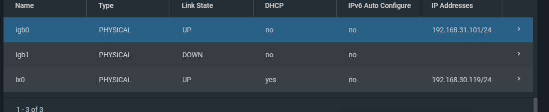

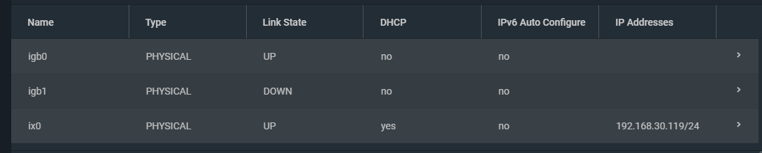

Currently I have my system running on a 10Gb intel fiber card. I am trying to get iSCSI set up. I am attaching a cat 5 cable to a separate nic on the machine. which is on a different VLAN (VLAN 31). Once I set up and try to test the connection. It appears that my all my Jails lose connection and I can't ping them or ping from them. Even after the settings revert back, I still have the same issue. I have to reboot the NAS for the connections to work properly again.
What am I doing wrong? How can I set up this different vlan on a separate nic so it doesn't seem to affect my main NAS, so I can pass the iSCSI traffic on that specific vlan.
I am trying to set this up under the interface section of the NAS GUI
Jails are using vnet0. It appears its set to auto_default_interface (Set to the 10gb interface and no luck)

Solved part of it. Needed to change the interface from auto and the default route was on auto too.
Still having the issue where I can't ping the second interface ip that I statically assigned
