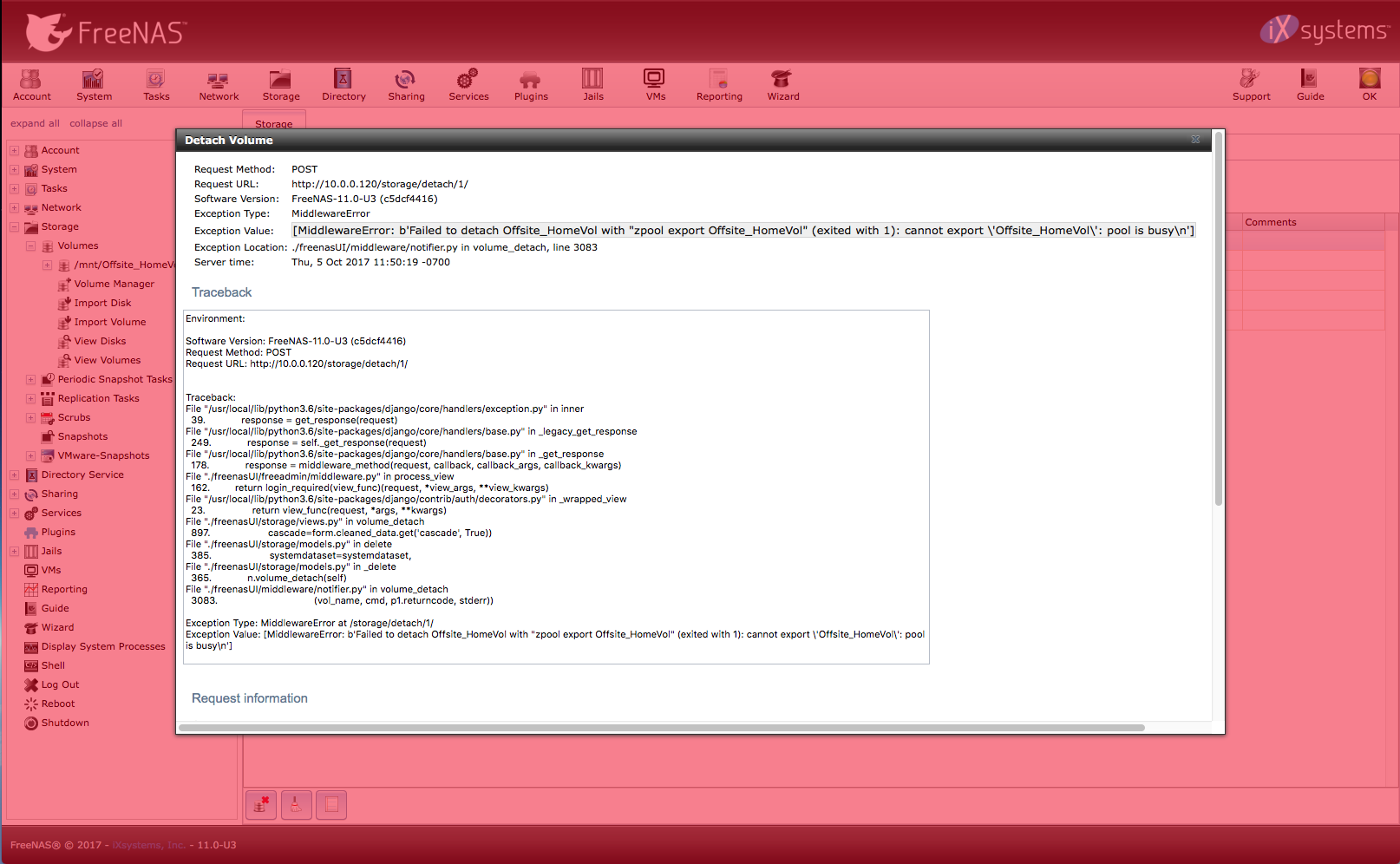

I'm having trouble understanding what you mean.
But since you seem interested in the troubles I've had, heres a screenshot on my other server which replicated the same issues I had the post above:
Stux
Jun 2, 2016
4,419
It means the pool is busy. Might need to move the system data set first. Or shut down jails/services etc.
