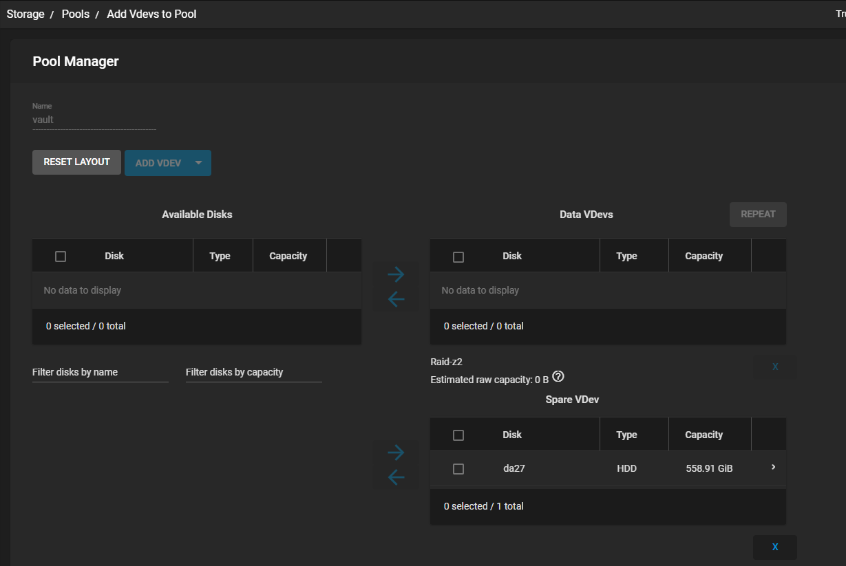

Hello, I am trying to add a hot spare to my already created pool. The only option I am seeing to do this is clicking the gear icon for the pool, adding a vdev, then selecting Hot Spare and the drive to that vdev. Unfortunately this was giving me issues since the page was already set up to add a raidz2 for some reason and I cannot get rid of it. I am getting the below error because of it.

middlewared.service_exception.ValidationErrors: [EINVAL] pool_update.topology.data.1.type: You are not allowed to create a pool with different data vdev types (RAIDZ2 and RAIDZ1).
This is what populates when I try to add the Hot Spare vdev. Any help would be appreciated here, thank you

You possibly cut it off in that screenshot, but do you have a Force checkbox available? (if so you can use it)
