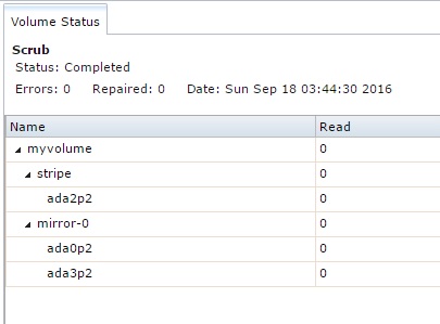

When you say destroy the pool, you mean destroy the data that's in the pool? (I don't really understand what I'm doing.) I think I added the drive to the mirror as stripped? This is what Freenas shows me now: <pic>

So now you have that single drive as a point of failure. This is fine but probably not what you wanted to do. To fix this you will have to backup all your data and rebuild the pool. There was a big warning telling you this when you did this so I'm assuming you knew what you were doing.

You could also add another (new) 3TB drive and mirror the one you just added. Unfortunately that would require you to use the CLI and I wouldn't recommend *you* doing it. Follow SweetAndLow's advice.

So, assuming you have want redundancy, you have three options.
1) add a fourth drive to mirror the third drive.
2) backup the contents. Destroy the pool and recreate it as 3 way raidz1
3) add a fourth drive, backup the pool, destroy it and recreate as 4 way raidz2
1) is probably best, and if you don't mind 50% redundancy will allow you a good growth path in Future.
