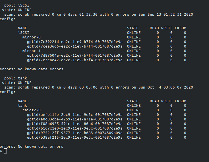

Hi thanks for your reply, this is what my configuration looks like.

Yes, you can add a disk to each "mirror" vDev for greater redundancy. This can also increase read performance because of the potential for 3 parallel reads to occur.
In general, iSCSI does better with more vDevs, so adding the 2 spare disks as another mirrored vDev is an option. (Of course, you loose the spare nature of these 2 "spare" disks. And you can't remove the vDev easily...) Also note that any existing data will still remain where it is, across just 2 of the 3 vDevs.

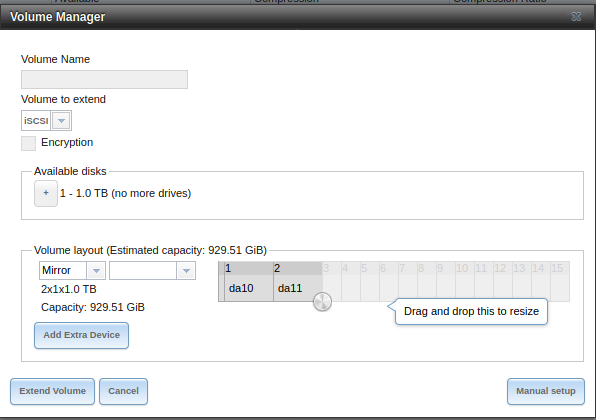

How exactly do i add two drives to each of the existing mirrors? Im guessing i dont setup another Mirror?
Some of the more advanced features, (and less commonly used), may have to be done on the command line. The GUI has changed a bit, so I don't know if it is possible from the GUI.
And correct, if you want to increase your redundancy, (and not increase the amount of storage), you don't want to setup another mirror.

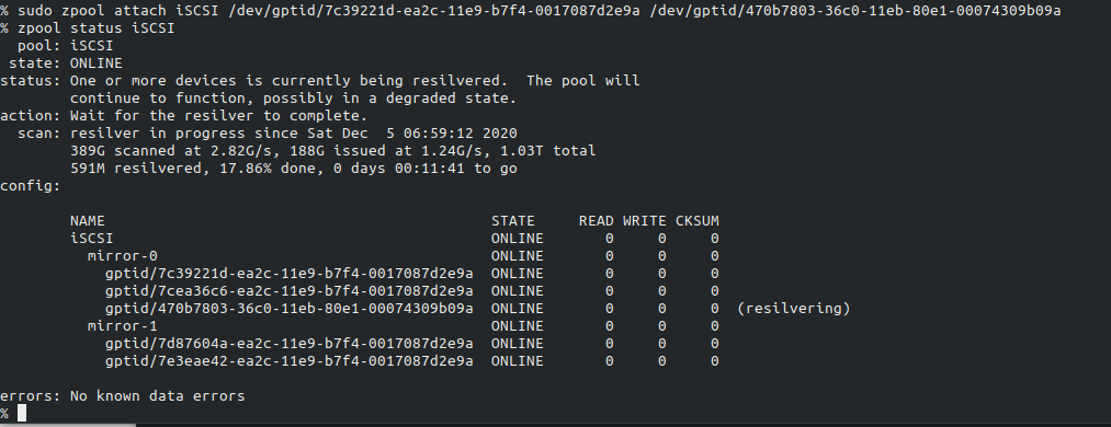

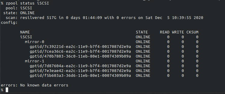

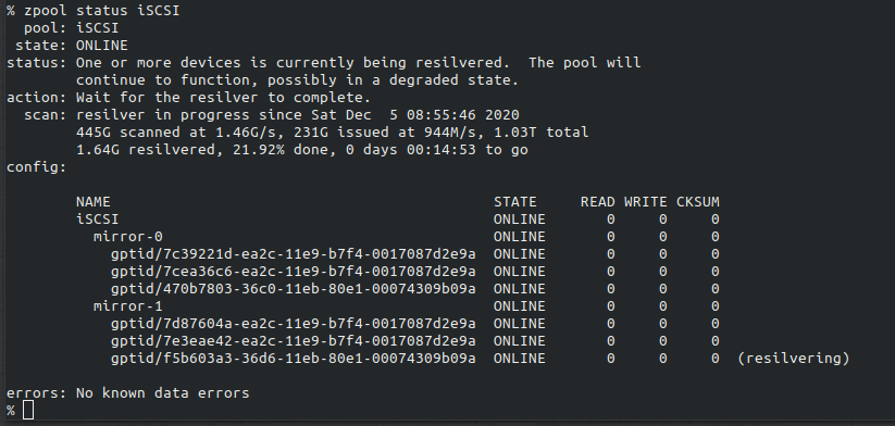

I got the drives added to the vDevs and up and running.

The final result looks good. You have your 3 disks per vDev mirror. The pool iSCSI can loose up to 2 disks per vDev, (for a total of 4 disks), without data loss.
2 things. First, if you used the command line to add the 3rd mirrors, the GUI may be confused on your iSCSI pool's layout. Every thing else should still be okay. A reboot tends to fix that. Or manual export and import of the pool, (from the GUI).
Second, if you got the partitioning wrong, you can have trouble. As I said, I am no expert in FreeBSD / NAS. But if you print out the partition table of the old disks, and compare to the new, if they are same, great. Otherwise you may have to fuss with it some more, (you can remove a mirror disk on a mirror vDev live).
