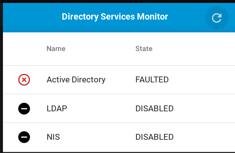

now it seems we have new experience. It somehow started working (U5), after restart NAS gets rejoined correctly (it is very probably connected to what @adocampo figured out) , wbinfo-u/g shows AD objects as well, shares are accessible from local lan , but there is one thing that still confuses:
This monitor still shows AD-Faulted ...
So , now we cannot determine whether something is still bad (and we do not know what) , or AD-service-monitor just does not work ... (!?)
BR
Tonci

Hello,
BR
Tonci
Update to previous post .... I should've been more patient :) ... Now it is OK .. after every restart ... (?!)
tonci
Mar 14, 2013
18
No, it isn't good ... there is no pattern ... after few new restarts , everything works but notification says AD-faulted .... for an hour already ...
