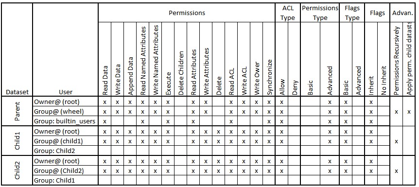

I’ve been trying to get my ACLs to work for the last couple of days but I think it is time to ask for help.
I created a parent Dataset and 2 child datasets.
I created a single SMB share for the parent dataset, that way when the clients access the share they could also access the child datasets as they appear as folders.
Pool
---Parent
---Child 1
---Child 2
My intent is not to allow anyone to create, modify or delete the contents of the parent dataset but i do want people to have full control inside the child datasets.
The ownership is as follows
  • Parent – root:wheel
  • Child1 – root:child1
  • Child2 – root:child2
My ACLs looks as follows
Everything works as expected inside the child datasets and people are not allow to create or modify the existing contents in the parent dataset.
However, when people are in the parent dataset, they can delete a child dataset from there. The dataset is not really deleted as it will reappear when they “refresh” their window but the contents inside the child dataset would be gone by then.
In parent dataset, no one has the permissions to “delete children” or “delete”. In the child datasets, the groups do have “delete” permissions as i want people to be able to delete the files they created inside the child dataset.
I can prevent people from deleting the child dataset if I remove the “delete” permissions for that child dataset. But this would also prevents users from deleting or renaming the contents inside the child dataset.
What am i doing wrong? How can i prevent clients from deleting the dataset via SMB?
ps. I'm using Truenas 12.0-U6

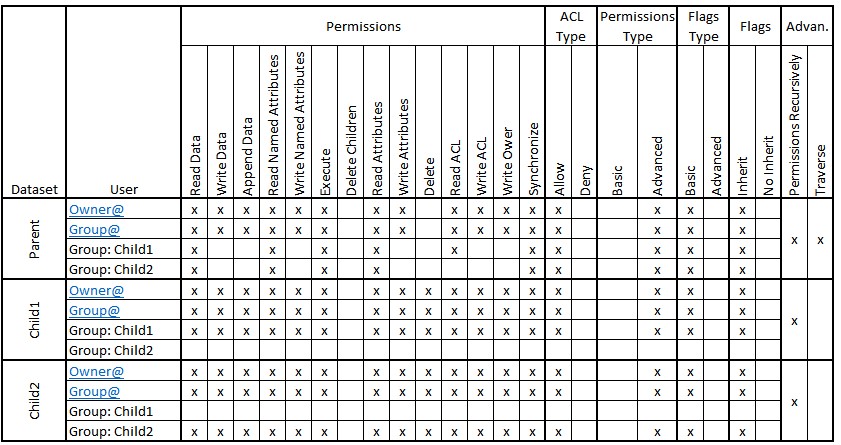

Update.
These are the things that i have tried but the outcome is the same (users can delete the child dataset folder presented inside the parent dataset via SMB):
  1. I changed the permissions from ACLs to unix type permissions. Then Set the sticky bit on the parent folder with chmod ug+t Parent but that didn't work.
  2. Set the sticky bit on the Child dataset folder and that didn't work.
  3. Changed the permissions back from Unix type to ACL type and un-selected the "Delete" permissions for the "Child1" and "Child2" groups. This worked but it also prevented users from renaming or deleting files/folders inside the child datasets.
  4. I added explicit "Deny" ACE for the group "builtin-users" and selected the "Delete" permission but this had the same outcome as #3.
I'm all ears if If anybody has additional suggestions.
I updated my permissions table to make it simpler and easier to nail down where is my problem.

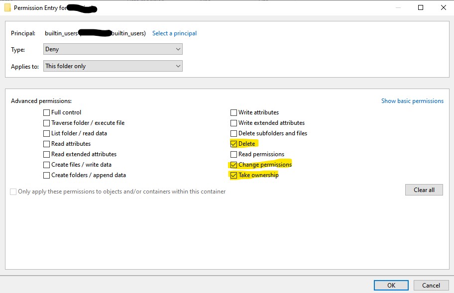

I finally figured it out.
In case someone else run into this, the solution was to add an ACE to each of the child datasets to Deny the “Delete” permission for the group “builtin_users”.
The catch was that i had to do this from windows. For some reason this method didn’t work when i tried to add this ACE directly from truenas.
So, in windows, i opened the SMB share and right-click the folder for the first child dataset. Went to properties, security, advanced and added the following permission entry
Now nobody (besides root of course) can do anything on the Parent share and the users can do anything they want inside their assigned child datasets. There is order in the world again.

@Sparky23 i will try to explain what i did in more detail. Maybe I omitted0 something last time.
Based on what you said, plex is a child set inside the main data set. If that is the case then what you need to do is (in WINDOWS) right click the folder for the child set "PLEX" and click on properties.
Then go to the "Security" tab and click on the Advanced button.
A new window will open. In there locate the user "builtin_users" and click on the Edit button. Note, if this user is not listed you need to click on the Add button to add it manually and then click on the Edit button.
Lastly, change the permissions to match what i posted before.
One last thing that i discovered after i did my last post. You need to restart SAMBA every time you make a change. I honestly don't know if windows changes the permissions of the SAMBA share or the ZFS child set but to be sure just restart SAMBA. I honestly restarted the entire NAS just to be sure.
