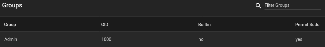

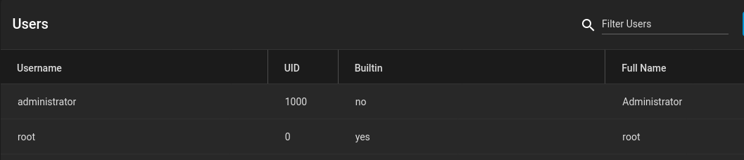

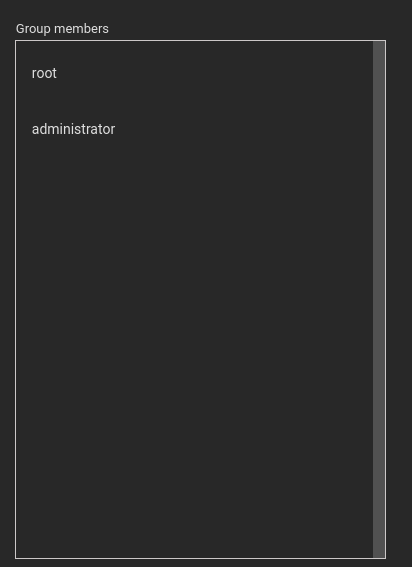

slkamath
Sep 15, 2018
14
Thanks for your information.
How to solve this issue?
Group ID 1002 is not there. I have created only 1 group. i.e Admin & 1 User i.e administrator. If I select Group Admin also I am getting same error.
How to change the ZFS Dataset readonly to read & write & execute?
