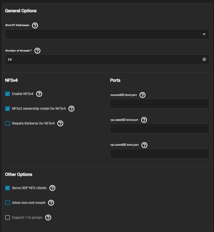

My truenas nfs service config is the following :

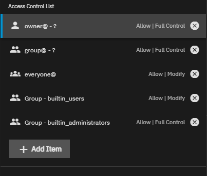

And the shared folder ACL access :
