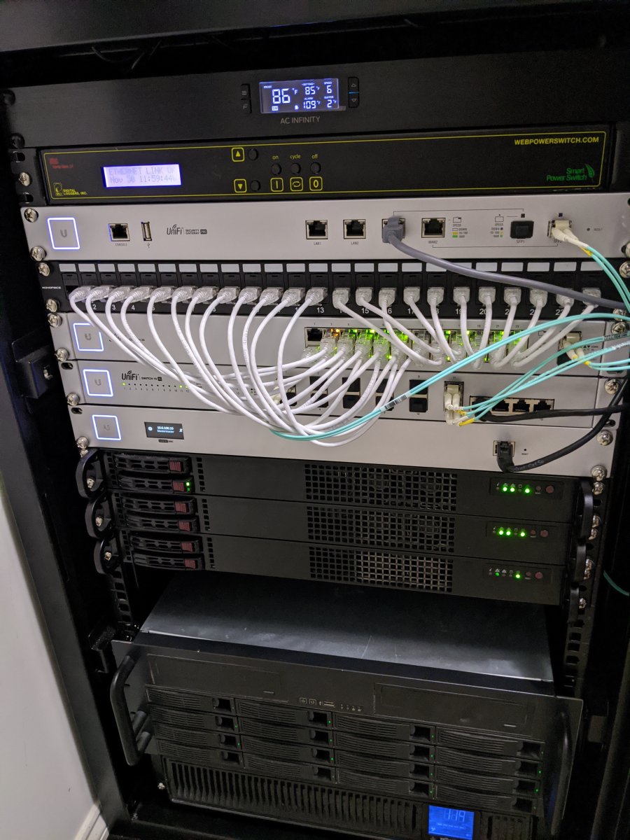

Here is a pic of the current setup in the closet. Ubnt gear with 3x proxmox ( X11SDV-4C-TLN2F) and the old nas on the bottom.
