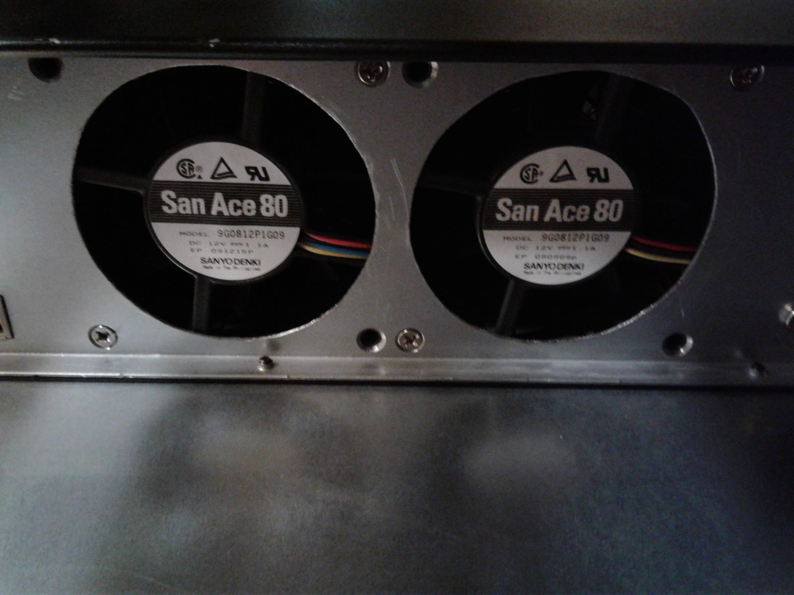

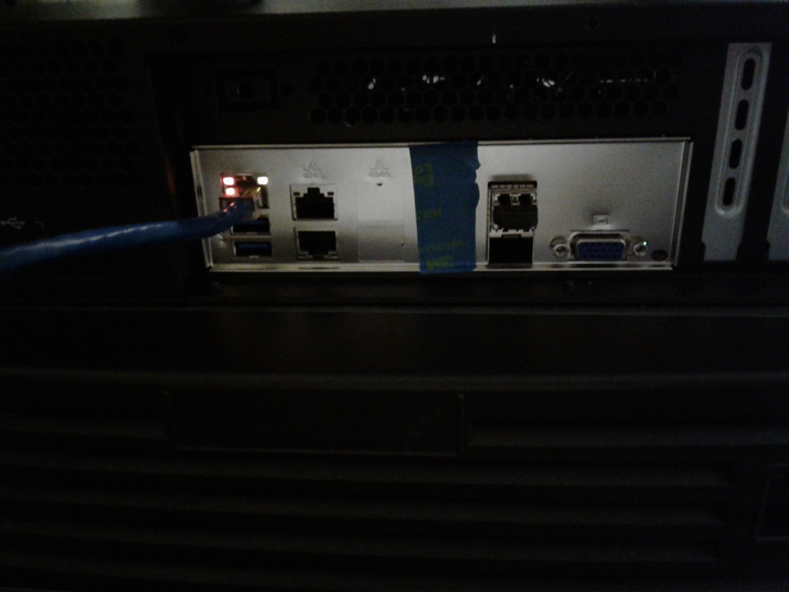

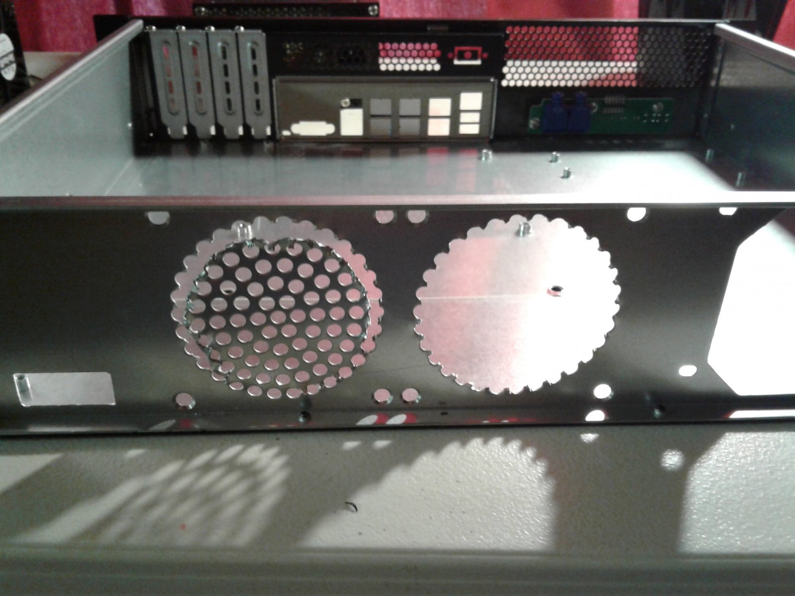

An update on my 10GB SPF+ pfSense build...
The X10SDV-2C-TLN2F motherboard turned out to be a bust for me because there
was no way it would interface with my 10MB ISP incoming line (thanks @Ericloewe).
Anyone interested in taking it off my hands for a reasonable price just send me a PM.
So I ended up buying an X10SDV-2C-TP4F instead, now it's up and running with one
little issue o_O
The 10GB SFP+ NICs onboard this most recent board are Inphi CS4227 and AFAIK are
not supported in FreeBSD as of this post, hopefully this will be coming in later versions.
For the time being, I've just added a Chelsio T420-CR NIC to the PCIe expansion slot
which works just fine as frogs hair :cool:
My new chassis for this build is working well and with the upgrade of the two 80mm fans
in the rear (stock fans totally inadequate) and have also ordered a 60mm fan which I will
attempt to mount blowing straight down on the passive (stock) heat sink. The rig is up
and running now, doing what pfSense does...;)
