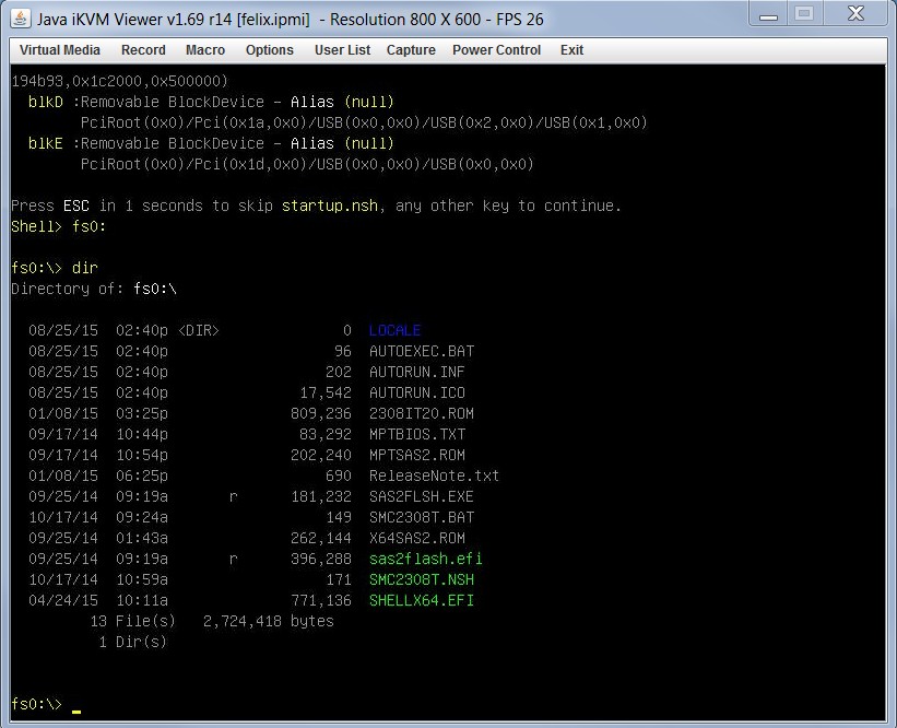

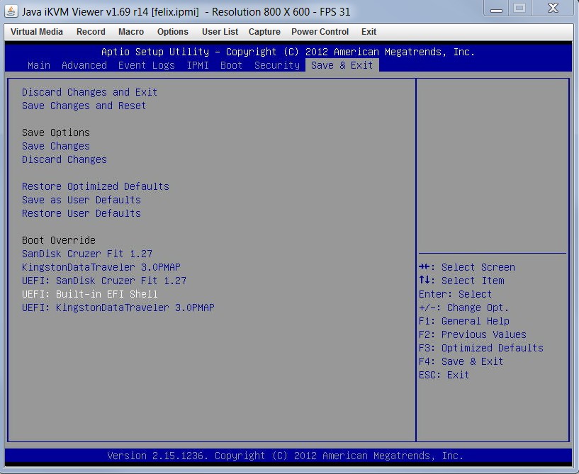

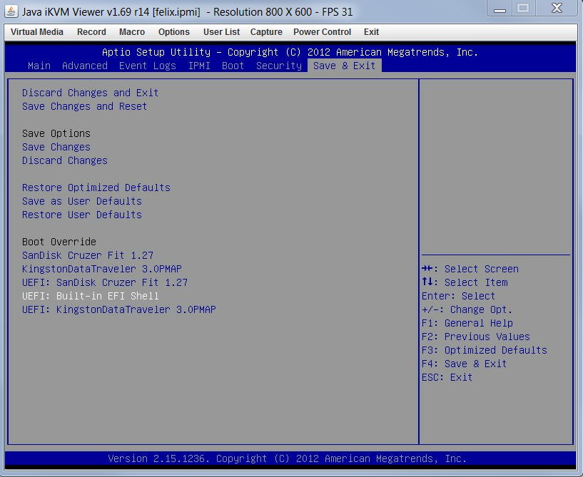

HardChargin said:
@Spearfoot Do you mind sharing your upgrade process for this board? I'm thinking to boot FreeNAS, verify update is available, detach pool, shutdown, unplug hard drives, upgrade LSI2308 firmware via boot utility, boot FreeNAS, upgrade FreeNAS, reboot/shutdown, attach drives, boot FreeNAS, attach pool. Wondering if all the back flips are really necessary, and also wondering how risky this update is as far as being time tested and potential for data corruption/problems. Thanks.
I'll be glad to do so, @HardChargin - I'll try to give fairly detailed instructions; please don't take offense and think I'm being condescending or anything like that if you already know about most of this stuff. :smile:
I had already installed the update on my FreeNAS server, not realizing that the new version required a firmware update for the on-board LSI HBA. Ooops! I have good backups, so I didn't bother with unplugging the hard disks or taking any of the other steps you described. Your needs may differ in this regard. In any case, my pool loaded up just fine after flashing the HBA.
Before you begin, note that you will need to know the controller's 16-digit SAS address, as the script provided by Supermicro will prompt you for the last 9 digits of it. I had noted down this information when I first constructed the server. If you don't have it handy, you can boot the system and load the LSI option ROM code to get it. (It may also be stamped on the motherboard itself, if feeble memory serves.)
I downloaded Supermicro's P20 firmware zip file (PH20-IT.zip) at this link:
ftp://ftp.supermicro.com/driver/SAS/LSI/2308/Firmware/IT/
Using Rufus on a Windows 7 PC, I created a bootable USB stick and extracted all of the files from the zip archive's \UEFI folder onto its root directory.
I also put a copy of SHELLX64.EFI onto the USB stick, but unfortunately I don't remember where I obtained it - and I don't think this file is required as I used the motherboard's built-in EFI shell. On reflection, I'm not even certain the USB stick needs to be bootable, since, again, I used the built-in EFI shell.
After gracefully powering down the FreeNAS server, I used IPMIView's KVM console on the same Windows 7 PC to mount the USB stick as virtual media on the FreeNAS server. I then powered up the server, entered 'Setup', and loaded the built-in EFI shell:
After the UEFI shell loaded, I entered 'fs0:' to select the USB stick as my current drive. (Note that your USB stick may not be located at 'fs0:' and you may in that case have to find it by trial and error.) Here is how my screen appeared after also entering a dir command to show the files on the USB drive:
Once you (finally!) get to this point, all you need to do is execute the Supermicro script by entering SMC2308T.NSH at the command prompt. After trundling along and doing its job, the script will eventually ask you for the 9-digit SAS ID. Once it completes you're done and can reboot the system.

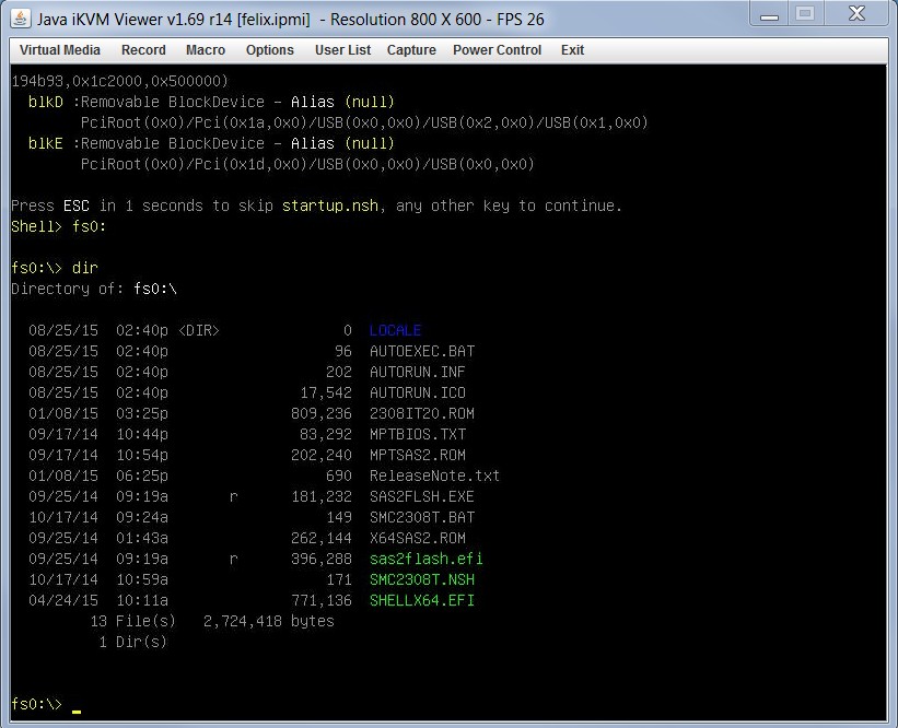

I'll be glad to do so, @HardChargin - I'll try to give fairly detailed instructions; please don't take offense and think I'm being condescending or anything like that if you already know about most of this stuff. :)
Good luck!
Wow! Thank you sir, for taking the time to write out such detailed instruction. I am semi familiar with the LSI flash process as I recently went through it when I built my system, and had planned on revisiting my notes, but you reminded me of a several things I had forgot about (like the SAS Address along with a few other parts of the process). Thanks again, much appreciated, and very helpful.
Update: Chalk up one more successful update/re-flash for an x10sl7-f. Updated FreeNAS, verified driver mismatch alert, rebooted, updated LSI2308 (now Avago) controller following Spearfoot 's instruction, verified LSI update in LSI utility, booted into FreeNAS, verified alert cleared, pool, and data intact. Didn't bother to detach pool or unplug hard drives. Nice to be on the "latest" version of controller firmware.

Excellent set of instructions Spearfoot - thanks! I was performing those actions exactly while you must have been typing that. I added an extra step of disconnecting my drives after shutting down the system. A couple points to add that anyone as unfamiliar as me might appreciate:
1. After you've flashed the firmware you can type the command "sas2flash.efi -listall" to show the controller and verify the current firmware version in the efi shell.
2. A video walkthrough can be found here for the process on X10SL7-F although its using old firmware versions: https://www.youtube.com/watch?v=5f1jhNKw33c
3. I saw someone earlier mention firmware 20.00.04 from LSI but Supermicro's is 20.00.02
I can confirm that after shutting down, reconnecting drives and finally rebooting into Freenas, green lights a cross the board and in my case it actually fixed the array order of my drives in Freenas to reflect which ports I'd installed them on the SAS controller which was showing incorrectly on firmware p16.
