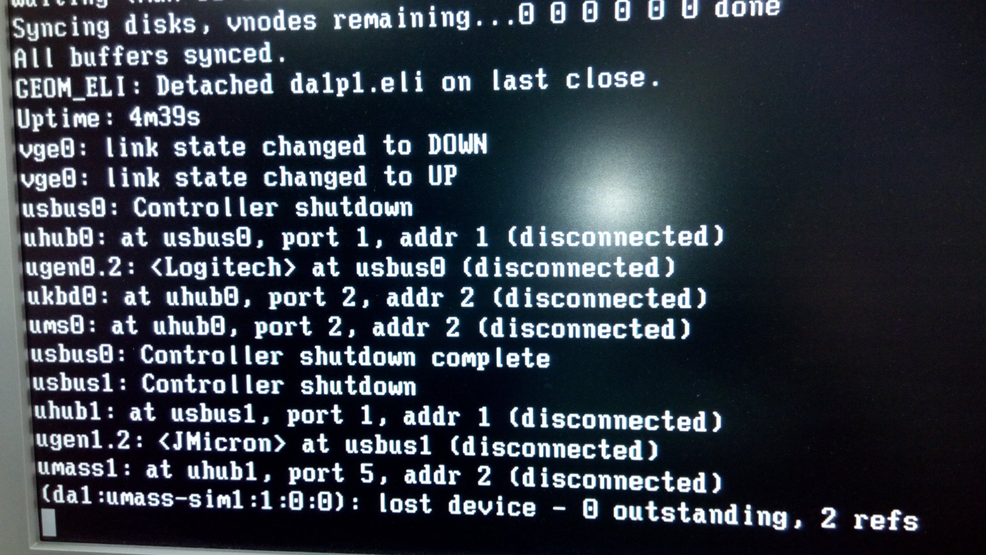

I'm unsure which caused the problem, the upgrade from a stick to a USB attached drive, or the upgrade to 9.1.1, but I encounter this error. The last message on screen is:
da1:umass-sim:1:0:0): lost device - 0 outstanding, 2 refs

Screenshot included with vga attached which also holds a ps2 mouse/usb keyboard on a usb RF receiver.
Edit; the problem also occurs when I shutdown.

Go to System -> Sysctls -> Add Sysctl
Variable: hw.usb.no_shutdown_wait
Value: 1

DUSAN ! thank you, it works perfectly
