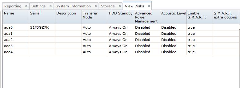

I upgraded a server from 8.0.4 to 9.1.1 and now the drive serial number is only being displayed for the first drive. The serial numbers on the other four drives are displayed as blank. Is there a command I can run to get it to detect and display the drive serial numbers?

Nope. Not using raid on the motherboard or an extender card. I'm just using a 6 drive AMD E-350 Mini-Itx motherboard with five identical SATA drives. The interesting thing is that it was having a problem with drive zero - it didn't look like it was seeing it. After upgrading to 9.1.1 I opened it up and checked the drive. It may have had a loose cable because after booting it up again it saw the drive and started resilvering/repairing etc. That is now the only drive that it reports the serial number on and the rest are blank. That can't be a coincidence.
Thanks for your link. Glad it was already reported and not just me.
