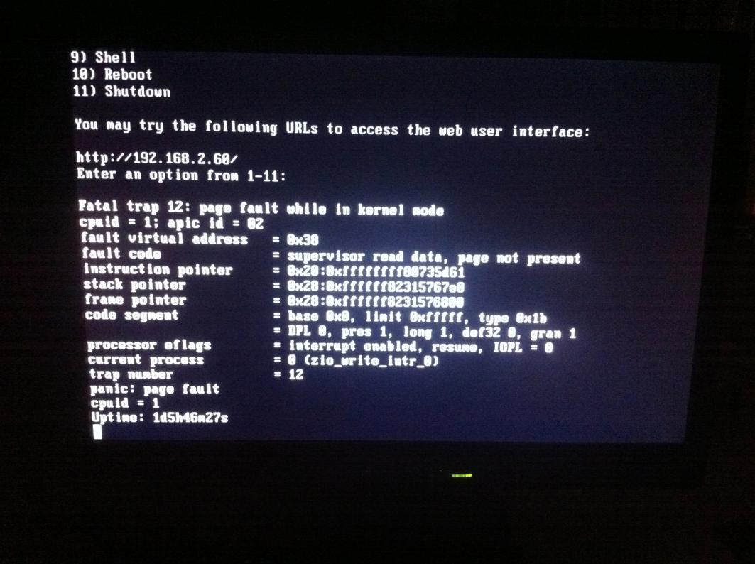

Fatal Trap 12 continues
The pain continues. So I thought i was out of the woods and was transferring 2-300GB piles of movies from one Freenas (7.2) to the new Freenas (8.0.4) and it went well for about 1.7TB. I was doing the copies via my mac - just dragging and dropping.
Then last night when I went to move the next pile, I got the "Fatal trap 12" error again (pic attached). Work is getting in the way of troubleshooting again, so it may be late tonight before I make it back, but any help anyone can give, again, is appreciated. Just as a refresher, i've got 5x1tb WD black drives plugged right into the sata ports on my motherboard, no controller or anything. They're a mix of Sata2 and Sata3 ports, so I don't know if they're causing the problem or not. BIOS SATA mode is AHCI and I just turned off the aggressive link power management option.

Well now I can pretty much reproduce variations of this error whenever I try to push 2-300gb to the server. After 8-10 minutes, I get a fatal trap 12 error. Always different processes listed when it bombs. I'm starting to wonder if I have a bad cpu. I've flashed the bios on the board and i'm not sure what a board issue would look like. I reran the memtest and it found no errors in another 4 passes. I figure it's either the CPU itself or the onboard sata controllers. I have an IBM m1015 on the way, but it'll probably be a week before it's here. I'm considering buying another G620 or an i3 and putting it in the box to see if it does anything. I also have a single 2tb drive that I'm going to hook up and try to do a large file push to it.
Any feelings as to whether my thought process is correct and how (if possible) i can tell if the board itself may be the problem?

There is a hardware problem. The difficult part is to identify what part that needs adjusting ( not neccessarily
replacement but maybe reconfiguration).
Reducing the complexity be removing uneeded hardware/software is one tool. Carefully replacing
selected items with simular but alternate design another.
You may try ( if memtest86+ is satisfied with memories ) using another nic, another disc controller
or another cpu.
If time is scarce and economics allow, returning the box altogether and use another where the vendor claims
"freebsd compatibility" might be an option. ( i know one distributor that claims supermicro has a range of such )

In my experience it's almost always the motherboard & not the processor.
If you have a spare PSU around swap it with the one that's in there. Failing PSUs can cause all sorts of weird errors.
Run survive's tests either way.
