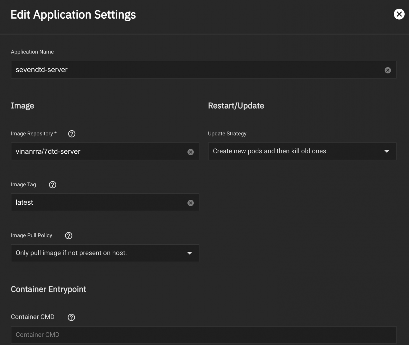

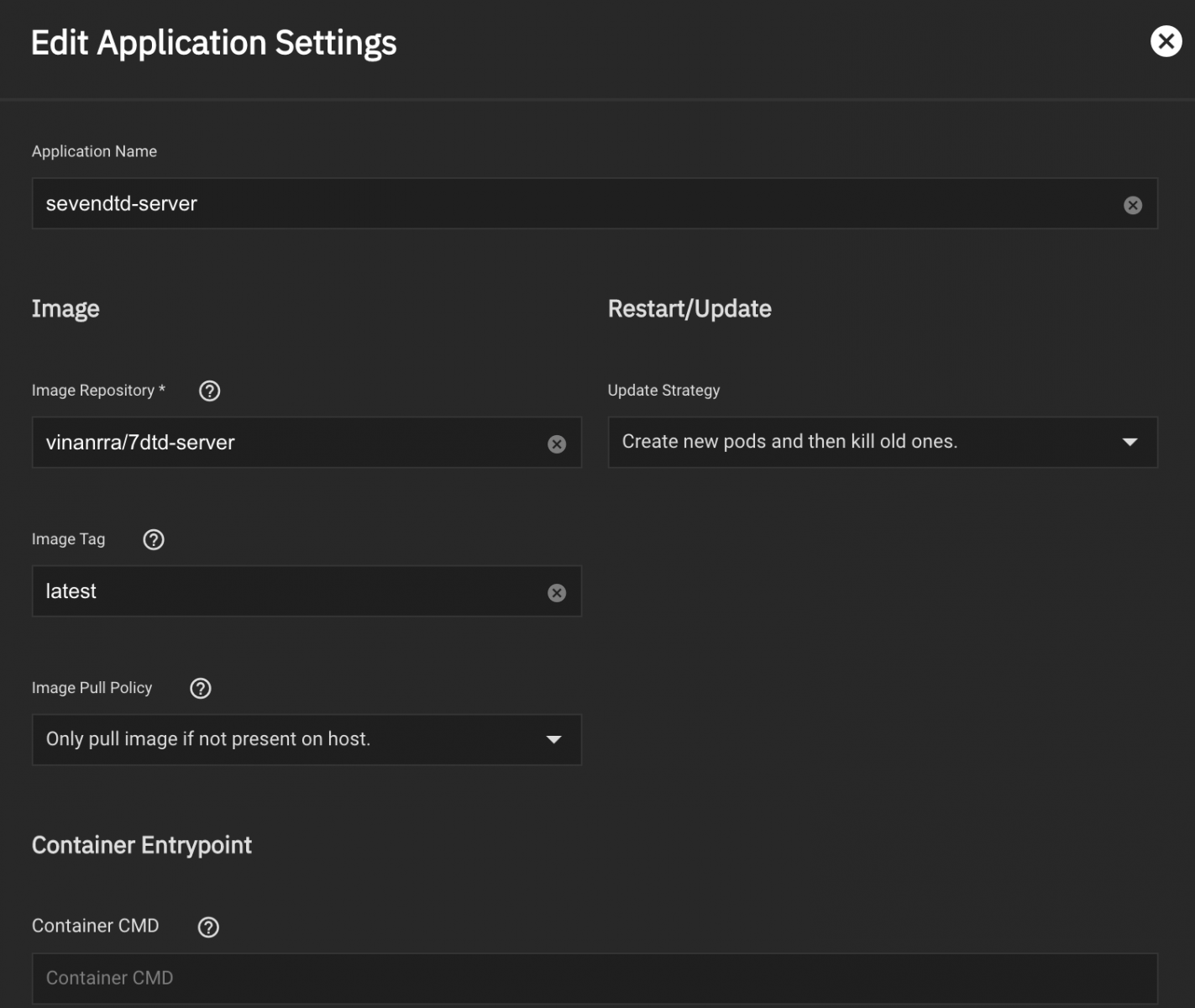

With the caveat that I have no clue about game servers, I was able to use the docker link you provided and spin up the game server using the "Launch Docker Image" button. So if you don't want to wait on the truecharts maintainers to add the app, you can go that route.
I wish there were an easier way to paste the config of an app, but hopefully these screen captures get you started...

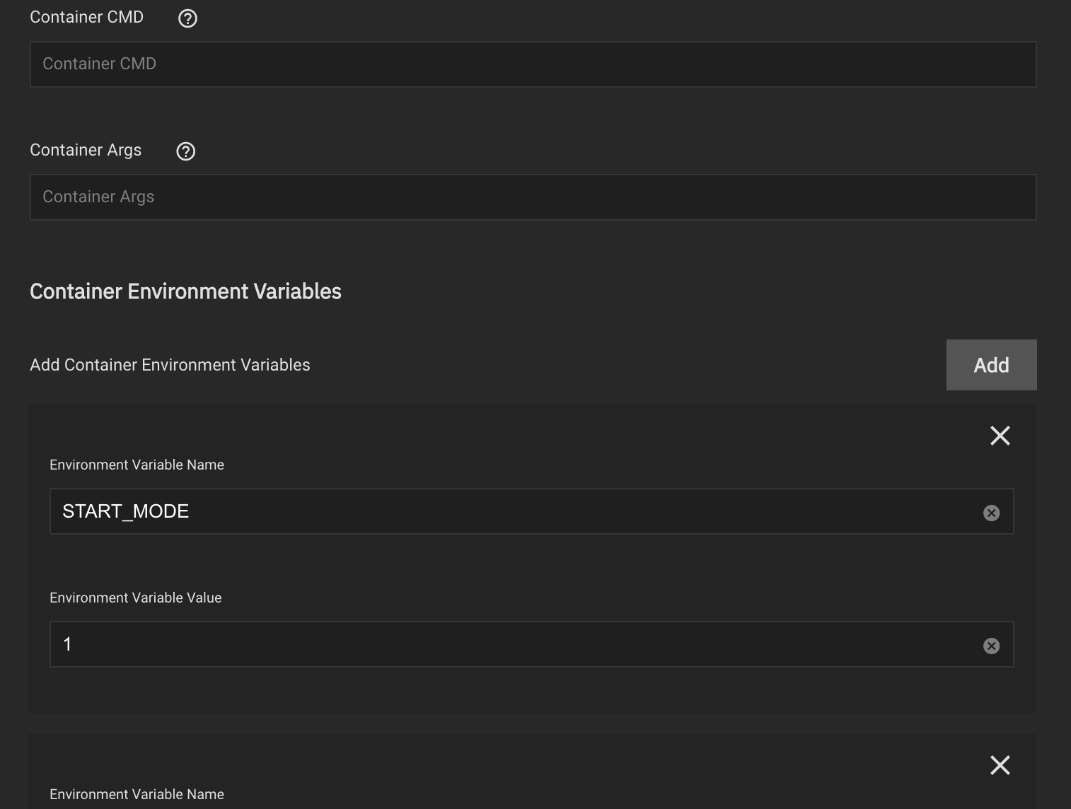

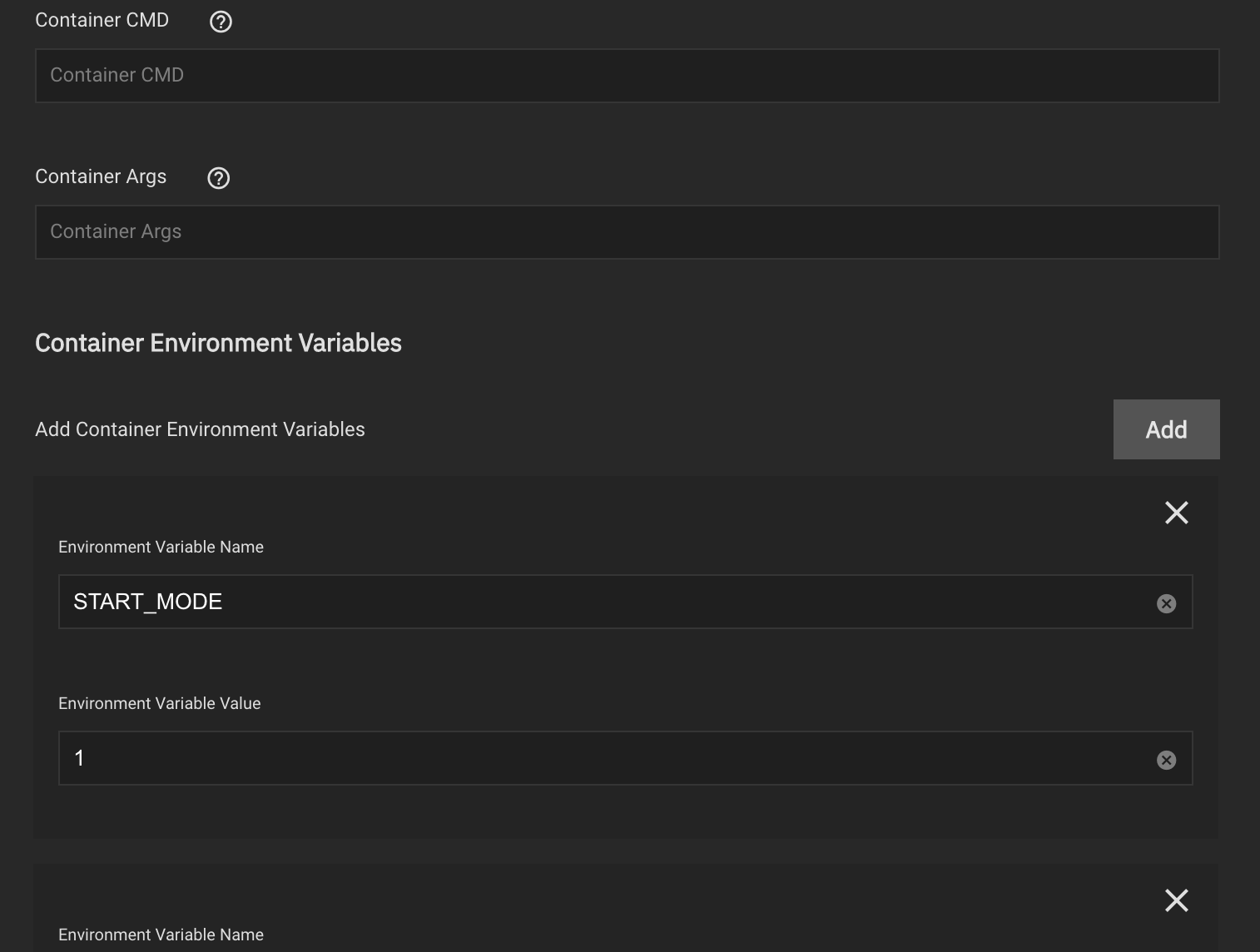

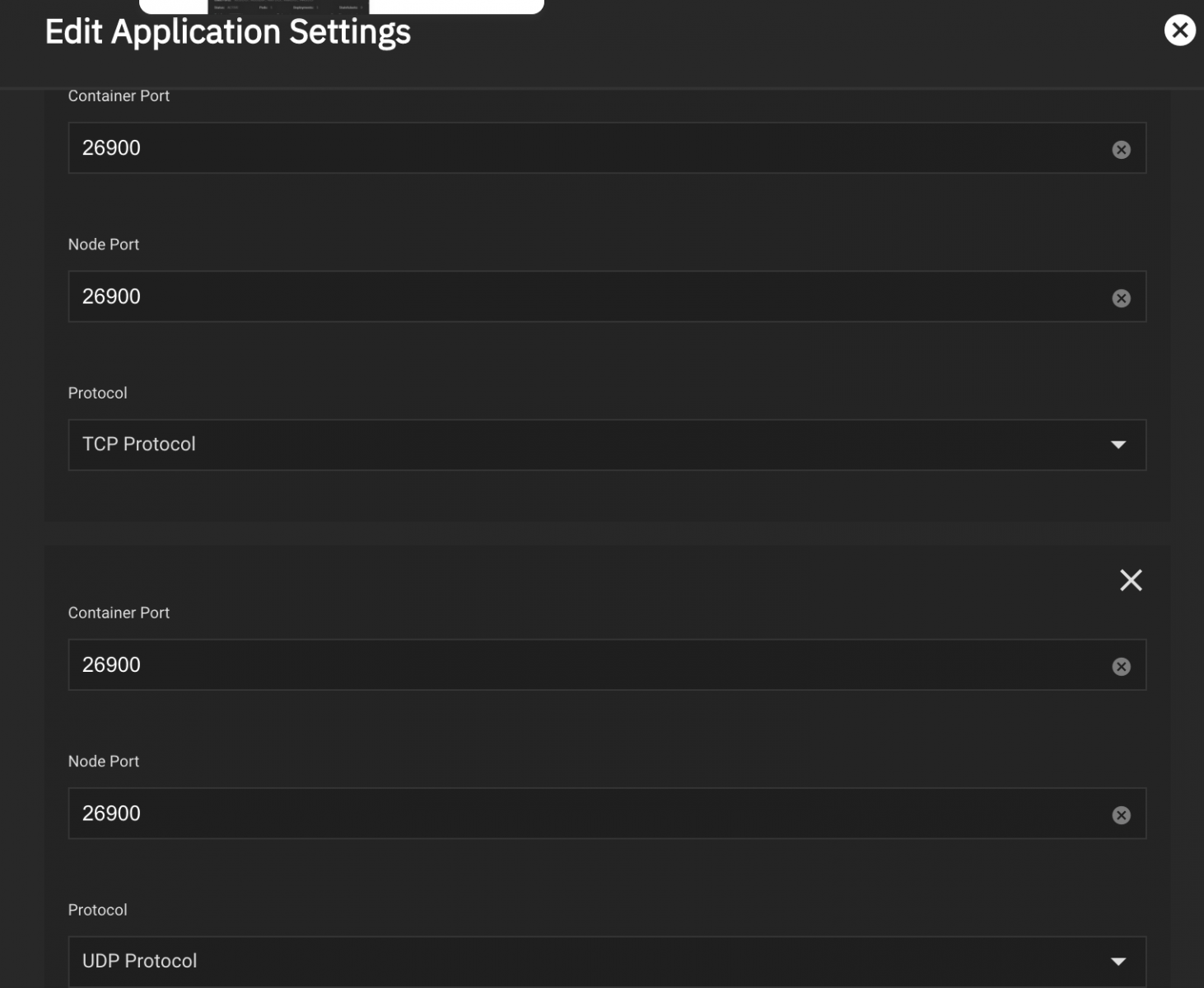

Env variables can get mapped like this:

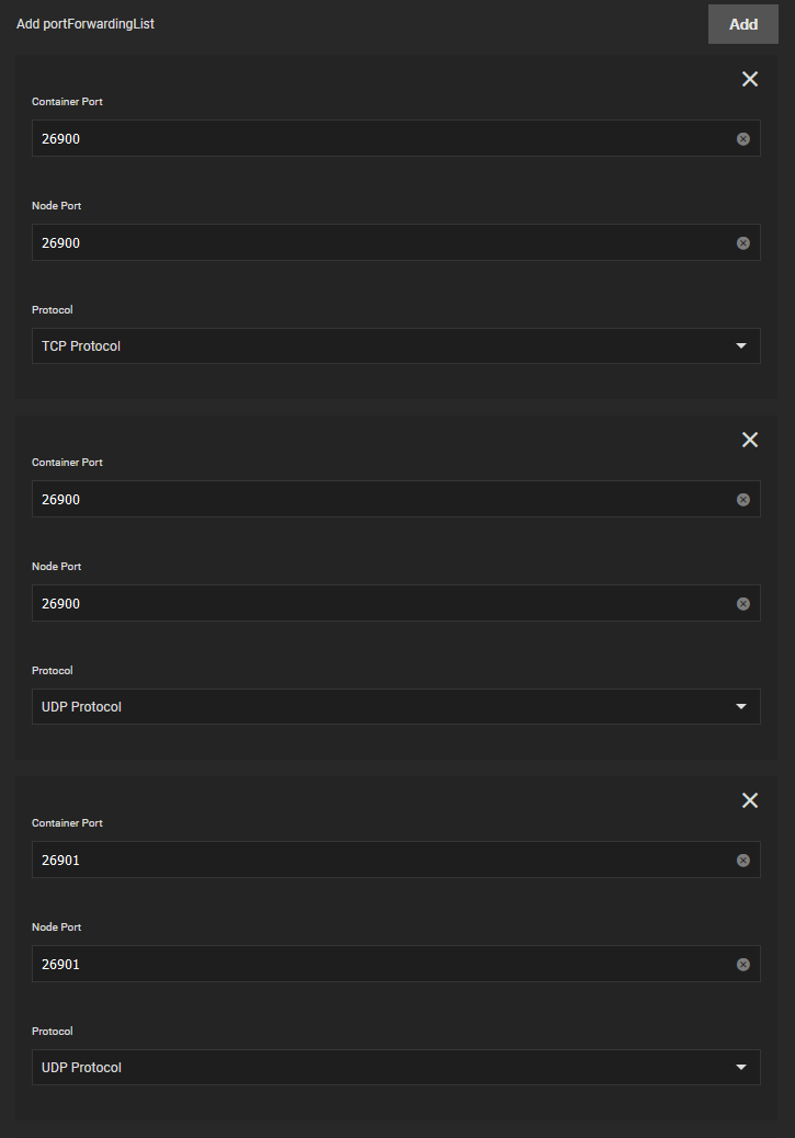

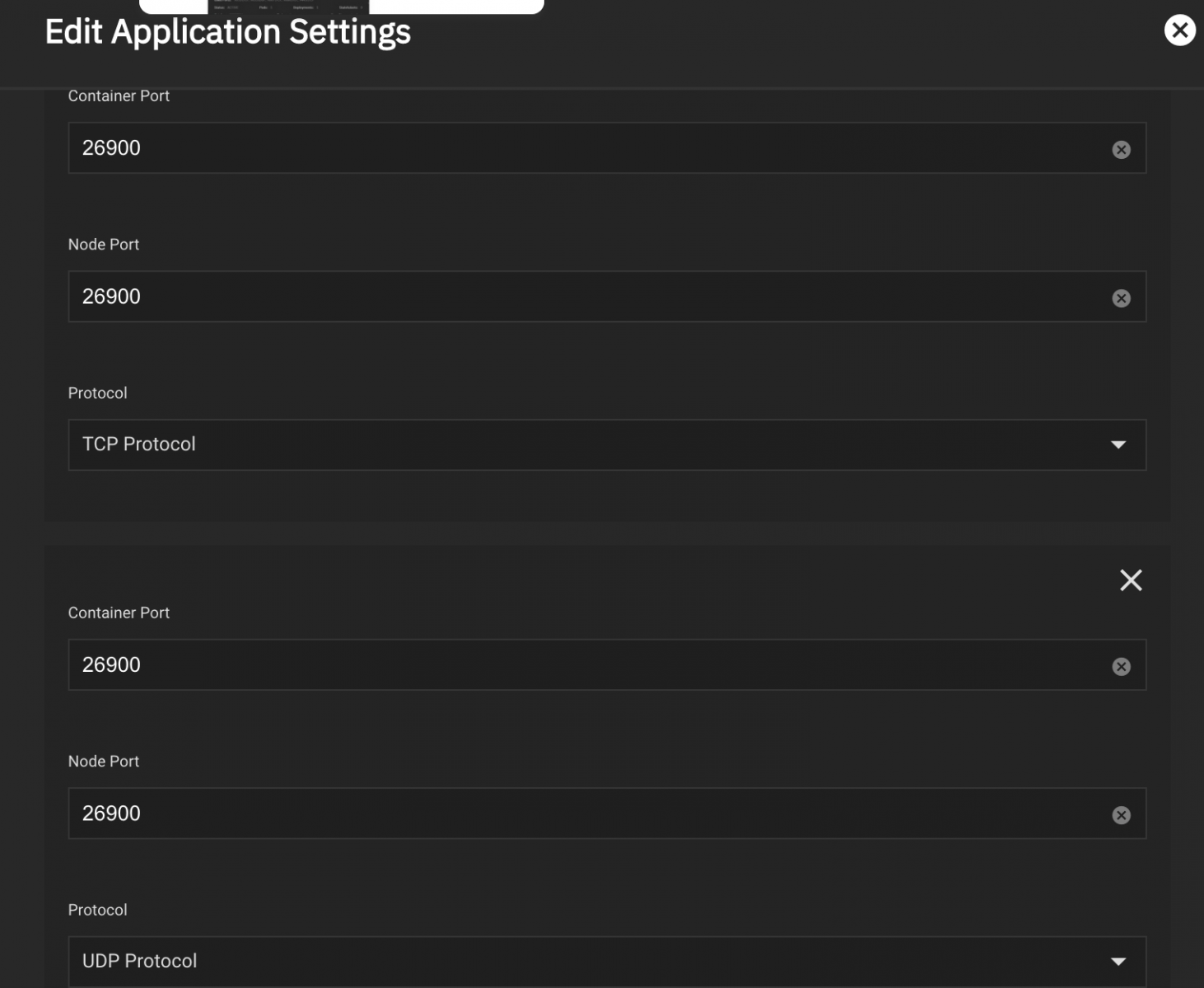

on the docker compose it typically corresponds to

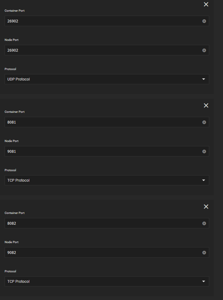

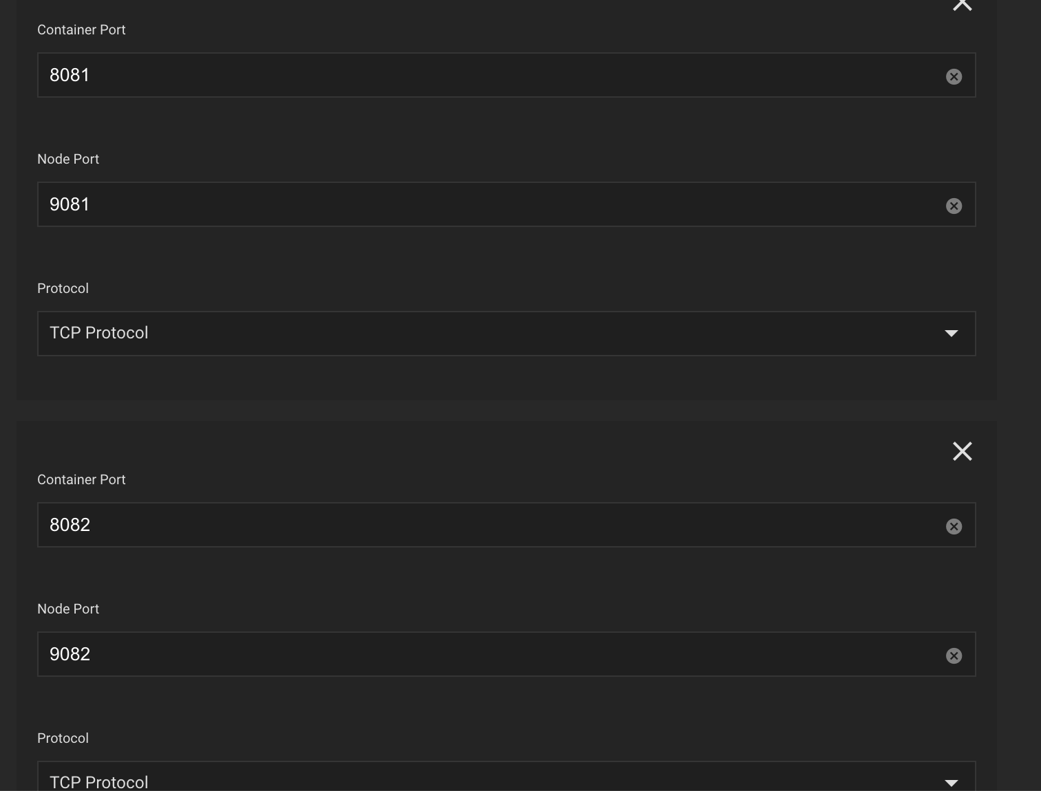

NodePort:ContainerPort in the config (note the separate TCP and UDP protocols).
For the ports below 9000, keep the container port the same and change the node port like this:

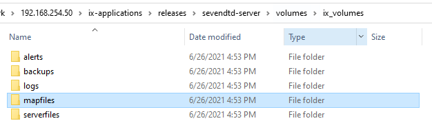

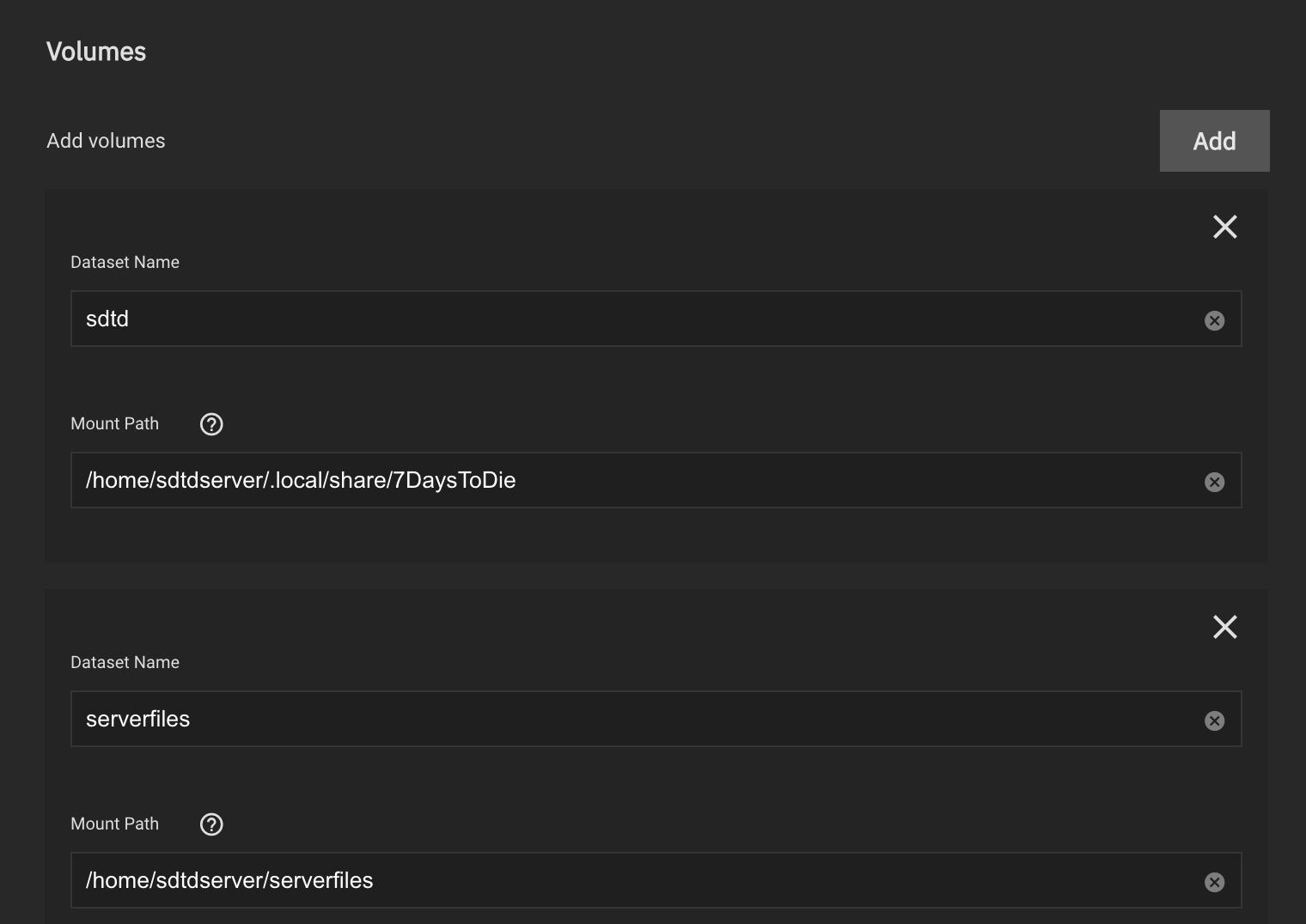

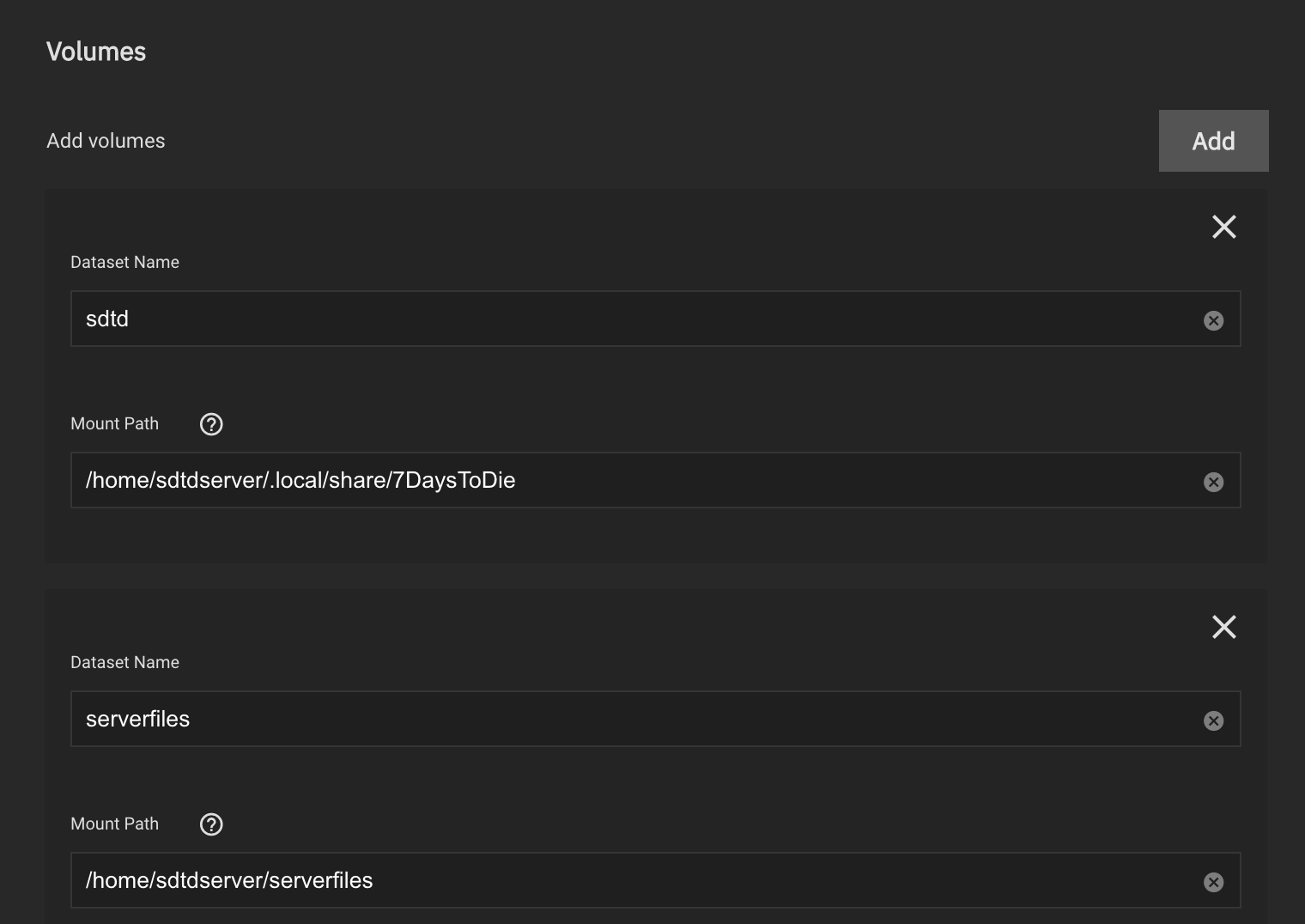

Volumes can be mapped as host path if you want to use an existing folder on your system or
contained within the app from scratch with Volumes (as shown here)

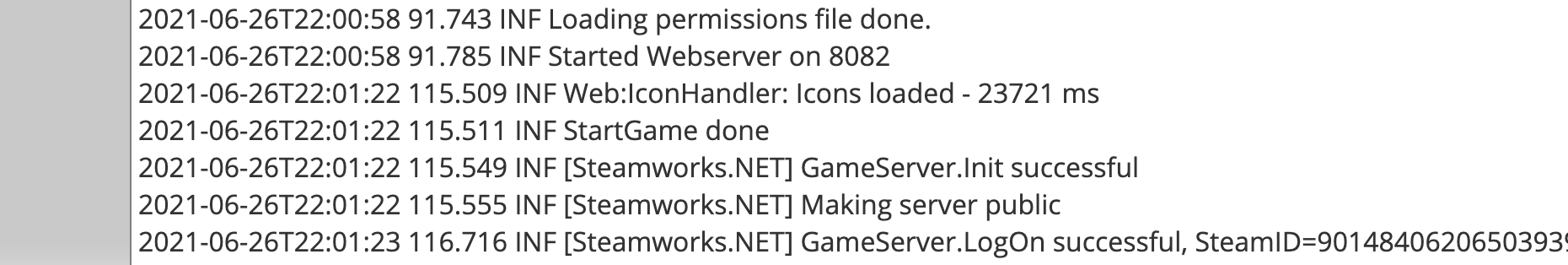

Restart the container and from the webmin portal at http://YourHostIPAddress:9080 after it's started:

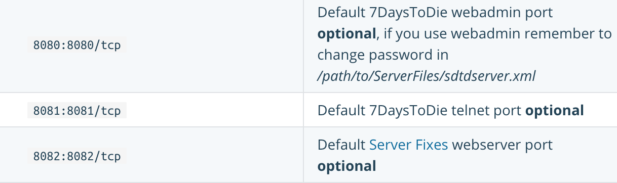

My comment about below 9000 is referring to a constraint from truenas (mentioned in their docs) nothing specific to the sdtd install:
"TrueNAS SCALE requires all Node Ports to be above 9000."
As to your question about 8081/8082, I just entered all the ports listed on the docker page, I have no idea how they're used. But it shows them as optional in the page.

It does created the folders, though, nothing in them.

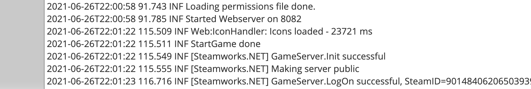

The logs are not pulling anything up...just a black screen.

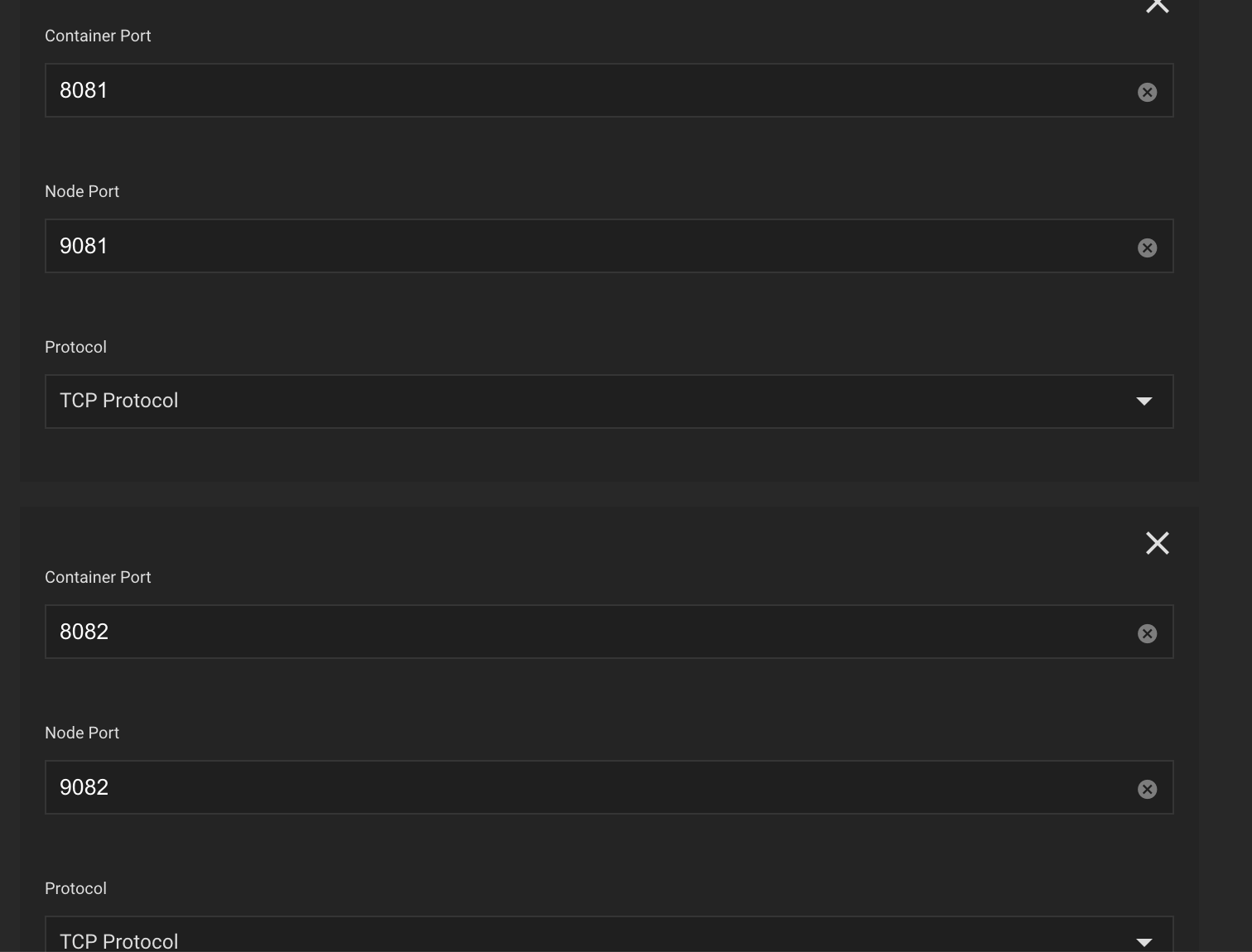

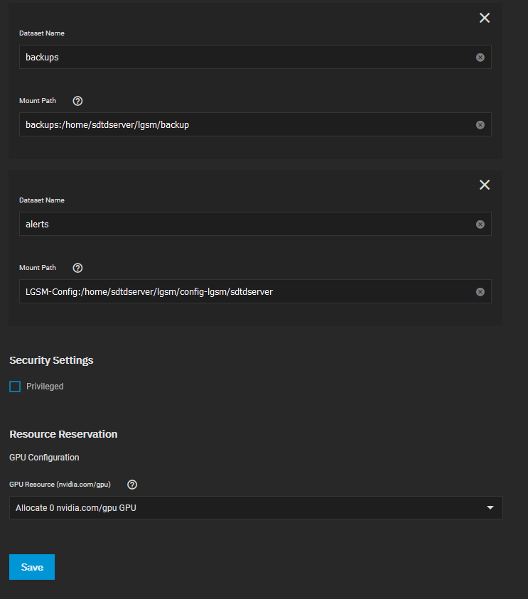

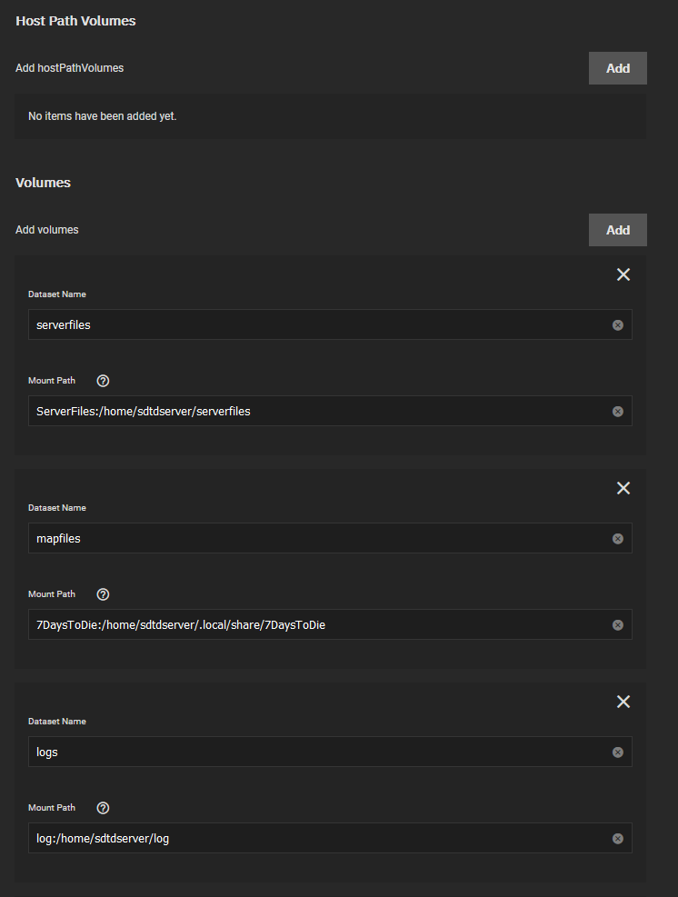

Attaching some screenshots of my settings...maybe something stands out to you?

change your volume mount paths to remove the "backups:" and "LGSM-config:" etc
the mount path in my screencapture above started with /home

Ok. So deleting those items at the beginning of each path seems to have allowed it to start!
Logs shows it's doing something!

I am unable to connect to the webadmin area - it seems it is getting the following networking parameters:
[94mWeb Admin url: [0mhttp://172.16.0.53:8080
The host IP is 192.168.254.50...do you know why it would be obtaining the IP above?
ksimm1
Dec 7, 2020
42
It's attempting to map like this:
Container http://172.16.0.53:8080 -> Node(Host) http://192.168.254.50:9080
the 172.16.xxx.xx is the internal container ip that you can ignore for this setup.
Confirm that the container port 8080 / nodeport 9080 mapping is configured in your settings (i didn't see it in your screencaptures), then try going to http://192.168.254.50:9080 in your browser.
(also make sure you modified that line in the XML file i mentioned in the earlier post)

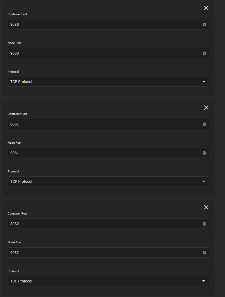

Would you be able to offer a screenshot of the network settings portion of it? I cannot get a good IP to establish. It keeps going to 0.0.0.0:8080 now.
I didn't see this reply come through. I did set it up as advised however it is unable to connect.

Got it!
So apparently, I had to try one of the other IP addresses of my server (have 4 of them plugged in - 2x10g & 2xgigabit). Silly.
