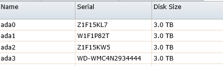

I have 4x 3TB Drives in on my FreeNAS box. I am out of space on my share and I do not think I am using all that is available to me. Can someone look at my pictures and lead me in the direction on how to resize the volumes or tell me why you might think I can't access all of my disk space. I need to figure out what I am doing wrong. I am experimenting with jails as you can tell my the screenshots. Thank you.

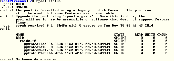

What's your pool configuration, i.e., the output of zpool status (in code tags, please)? Do you have any quotas or reservations set for your media dataset?
Thank you so much for the quick reply. The zpool status produced the attached result. How can I tell if I set reservations on my media dataset?

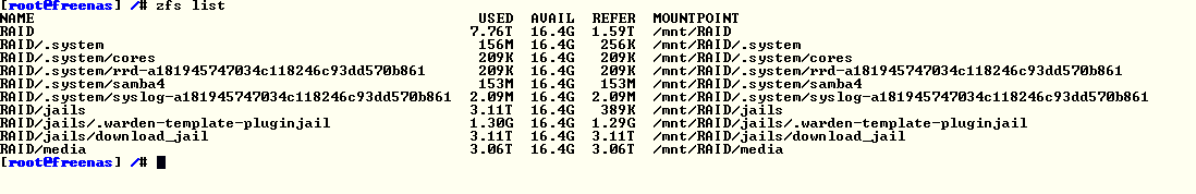

zfs list shows whats in the screenshot. I had videos in the RAID/Videos a while back. Then I started messing with Jails and in order to access the Videos from the programs such as Plex and others, I had to place the Videos inside the Jails. Well, I want to get rid of the Jails completely and put the videos back in RAID/Videos where they were before. When I went to move them back to RAID/Videos, I ran out of space when before it used to hold them all before I started messing with the Jails. I am thinking creating the Jails has jacked up my space. I need to get the videos back to RAID/Videos though before I destroy the Jail.

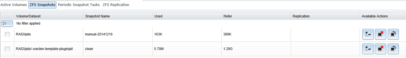

Have you taken any snapshots?
The only snapshots that I know of are a snapshot of the jail. See attached picture. I access this by going to Storage, and then ZFS Snapshots. Thanks!
