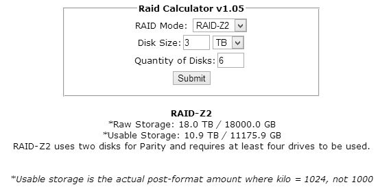

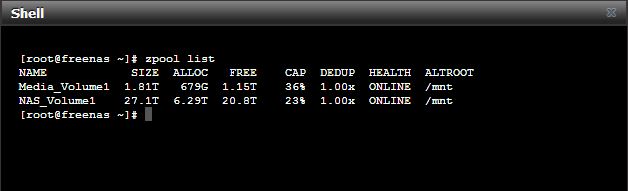

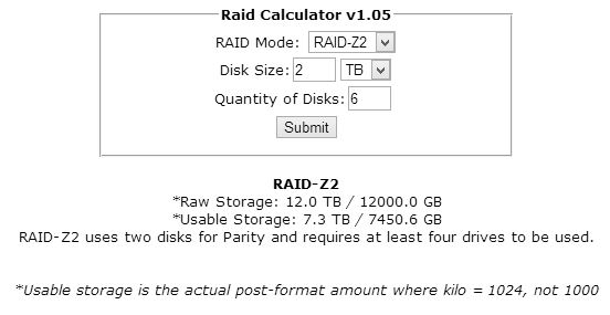

I had an initial Vdev of 6 x 2TB HDD's (Raid-Z2). This was getting me 7.2TB of space after formatting (going off my memory). I was running out of space, so I used the GUI to expand the Zpool with a second Vdev of 6 x 3TB HDD's (Raid-Z2). It recognized the 3TB HDD's just fine.
After adding the 2nd Vdev to the first, my total usable space for this Zpool is 16.6TB. From my calculations after formatting, I should be getting 18TB's of space.
Is this just me messing up on my calculations and the total usable space should be 16.6TB or am I truly missing 1.4TB's of space after formatting?
