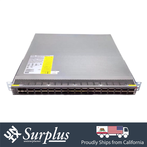

kspare
Feb 19, 2015
508
Check ebay for cisco nexus 3132 or 3164 switches. they are check and they work great. They are all 40gb ports, but you can get fan cables that break out a 40gb port to 4 10gb ports easily.
