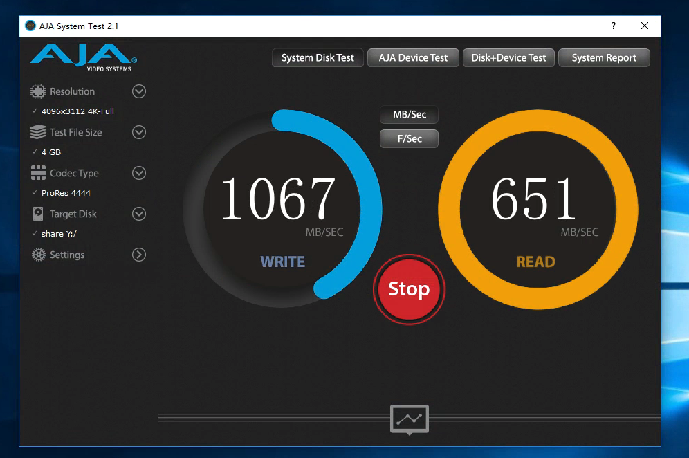

Sorry for my english. I just build the 40GbE server with Freenas 9.10.2 U3 offical version, and not that good performance, may be I have something wrong for tunable settings ?
the performance is like the picture in the attachment
If ESXi supports it then I'd think stability wouldn't be an issue. The only real issues I see with people using ESXi is the ability to turn off all the VMs before turning off ESXi, and any dependancies with the VMs. So if you had an iSCSI or NFS Share on FreeNAS to other VMs, you need to shut down the other VMs first and FreeNAS last. All hell breaks loose if you shutdown or reboot FreeNAS first.
When/if you setup a 40GbE then please post your results. A nice writeup could benefit many other people considering this path. Also touch on the Pros and Cons.
Good Luck, hope it all works out.
the performance is like the picture in the attachment(May I should use Freenas 11? has more deep optimize for SAS3.0?)
My hardware is :
intel i7 3930k
32g ram
gigabyte x79-ud3
lsi 9300-8i with itmode
intel xl710 qda1 Qsfp+ ports
18*seagate 3tb 7200 64MB DESKTOP HDDS
The client's is :
e5-2620v4
gigabyte x99-ud4
16g ddr4 ram
intel xl710 qda1 directlly link to server
for SAS3.0, it should can run around 3.X GB/S but not just 30% or more less performance.
May be somebody can help me. Thanks advance.
