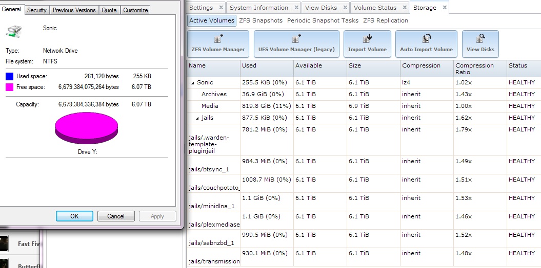

I've had my server up for a couple days now and have been slowly researching into NAS. As I can see I should be getting 7.5 - 9 TB usable storage with my setup but I recently looked at my storage capacity (after transferring most of my data) to see how much space was used/free and its showing only 6.1 TB usable. I am about to move the data off the server to recreate the the ZFS volume but was hoping someone could tell me why this is happening.
Searched forums and google for similar info. to no avail. Maybe I just created the initial volume incorrectly but I am 99.9% positive that I selected all 4 drives and made it raidZ2.

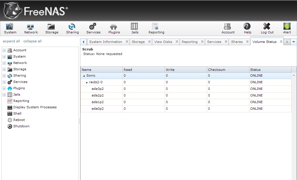

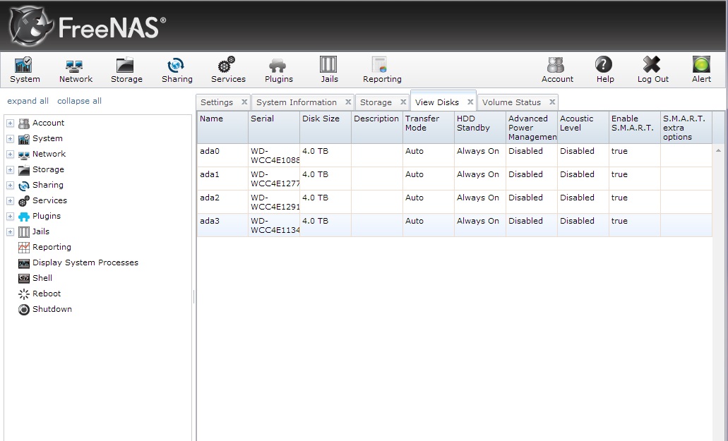

Post the output of zpool status on pastebin and I can tell you if it's a RAIDZ2. But if you have 4 disks and expect 7.5-9TB of storage space, that would mean you should have 5TB hard drives. Do you really have 5TB disks?

Again, I am new to posting on forums and FreeNAS so I apologize if formatting and what you requested was incorrect. I was under the impression that with a 4 HDD setup that I should expect approximately 1/2 of the total HDD space as usable and 1/2 would be mirror or backup in essence.

Well, I asked for the output of zpool status from the CLI... but your screenhot happens to be sufficient.
Yes, you have a RAIDZ2.
In a 4 disk configuration a RAIDZ2 is about 1/2 of what you'd get. Your drives are 4TB. Subtract from the TB to TiB conversion because of the disparity between hard drive size manufacturer's use and your standard setup and you'd get something like 7.5TB or so.
I see nothing wrong though. Everything is as it should be.

May 2, 2014
10
It seems showing this way still shows less than that. Maybe I did a wrong step somewhere else but as far as I know I did not reserve space for anything. Hah, thanks for the help btw. This screen is after putting maybe about 1 TB of data onto the system.

Right.. you have reservations set somewhere.
ZFS plays tricks on admins because it has datasets, reservations, quotas, snapshots, etc. The numbers mean what they mean based on your settings. For example, look at your Windows shot. You have 255KB used. Clearly that is blatantly wrong since your Archives and Media are almost 850GB.
If you really want to breakdown how all the numbers work out I'd suggest you spend a few hours with Google and play with FreeNAS in a VM until you understand it.
