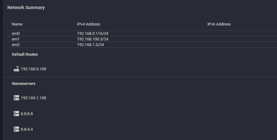

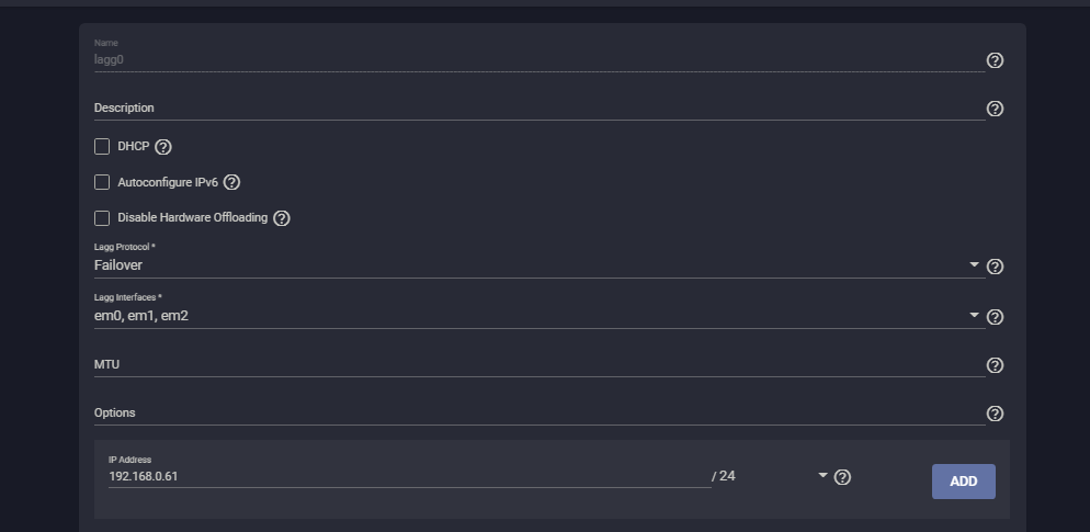

I read it is possible using lagg. I tried to setup but i got confuse, im trying to use webgui

Know that putting 4 NICs in a LAGG will not give you 4 times the bandwidth. If that was your goal, better stop right here...
Is your switch even capable of LAGG ?

that was my goal... if i want use one card for each process...
1.- share smb (read)
2.- share smb (write)
3.- shre NFS
4.- emby plugin
thanks
i dont know if my switch handle lagg (how can i check?)
Not going to happen, especially splitting the SMB read and SMB write. See:
4.- emby plugin
This one could, perhaps, be made to work. Jail networking is kind of a black art though.
Why do you want to do this? Do you expect to need more than 1 Gbit/sec bandwidth?
The manual for the switch should tell you (and if it doesn't have a proper manual, that by itself is a good sign that it doesn't--LAGG is the domain of managed switches that take more than a pamphlet to document).

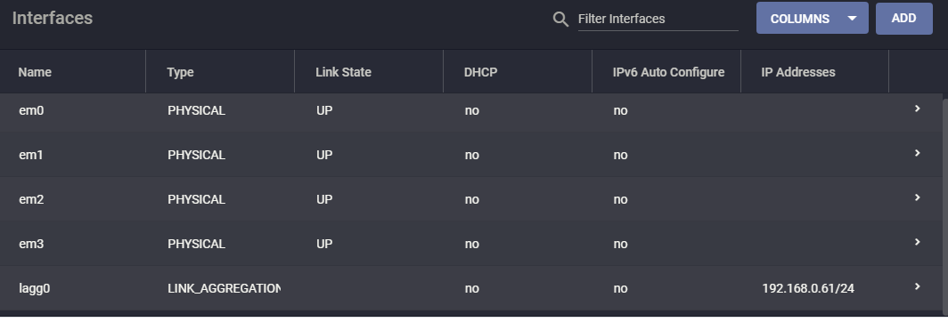

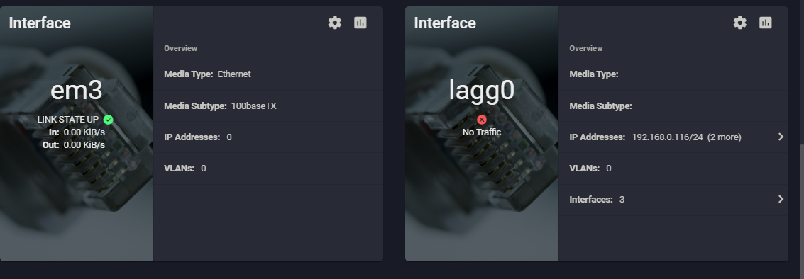

the problem is only 1 nic works. the others are ON but didn't do anything. i want speed up a little bit.. sometimes I'm streaming from the nas to 3 devices and get some buffering, any ideas what can i do?
thanks
Unless I'm mistaken, that's pretty much what the link I gave you says would happen.
This isn't a network bandwidth limit--even 4k RAW isn't close to a bitrate that would result in three streams saturating your network. It's hard to say where it could be--it might be CPU-bound (Emby, IIRC, is even more demanding in that regard than Plex), might be IOPS, might be something else--but it's pretty safe to say it isn't network bandwidth.
LAGG is a partial answer to your question, but you'd need a managed network switch to do it. A better answer would be to upgrade to 10G, but that would also need a new switch.
