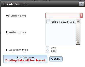

1, Can't add a 2TB hard drive via the GUI.
My setup is fairly straight forward (I think), three 1TB drives, configured RAIDZ and one 2TB drive, which I intend to use for snapshots. The three 1TB drives work fine and I have a number of ZFS datasets configured, however, I can not get the 2TB drive to be seen by the FreeNAS GUI.
When I run "camcontrol devlist", this is what I get the following
<SAMSUNG HD103SI 1AG01118> at scbus0 target 0 lun 0 (ada0,pass0)
<WDC WD20EADS-00R6B0 01.00A01> at scbus1 target 0 lun 0 (ada1,pass1)
<SAMSUNG HD103SI 1AG01118> at scbus3 target 0 lun 0 (ada2,pass2)
<SAMSUNG HD103SI 1AG01118> at scbus4 target 0 lun 0 (ada3,pass3)
<USB 2.0 Flash Disk 5.00> at scbus9 target 0 lun 0 (da0,pass4)
ada0, 2 and 3 are being used in the RAIDZ, da0 is where FreeNAS is installed, and ada1 is the 2TB drive. So, at the operating system level the drive is being seen.
2, Attempting to create a new volume using the GUI lists a drive already used in my RAIDZ ??
When I look at using the FreeNAS GUI to add the 2TB disk as a new volume for some reason the GUI is listing "ada3" as being available (931GB, please see attached screen dump). How ? Why ?
Any pointers would be greatly appreciated.

Hi leenux_tux,
You didn't mention which specific version of FreeNAS you were using 8.0, 8.01, amd64, i386, or your hardware. I've seen other users with this problem and it seems like it's a bug in the GUI. I don't know of any work around unless it's been fixed in a nightly build. How were you planning to configure your 2TB disk?

FreeNAS GUI states I am using "FreeNAS Build: FreeNAS-8.0-RELEASE-i386 I have a feeling you are going to advise me to upgrade !! :smile:
Yup! Actually besides upgrading, you can run the x64 (amd64) build on your Atom which will make a difference, but as for your disk problem I don't have an answer. I know I've seen several posts with the same issue, so that leads me to believe its a GUI problem.

FreeNAS GUI states I am using "FreeNAS Build: FreeNAS-8.0-RELEASE-i386 ". I have a feeling you are going to advise me to upgrade !! :smile:
If he doesn't, I will. :P
8.0.1-Release has a lot of fixes for bugs present in 8.0-Release.
You should also choose the AMD64 build when moving to 8.0.1 as your Intel Atom supports 64-bit.
Due to an increase in the build size of 8.0.1 you will need to re-create your boot media from scratch (you can't do an upgrade via the GUI) so backup your config if you want to restore this. If booting from USB then the ideal solution would be to install 8.0.1-Release on a new memory stick (minimum 2GB size) so that you can always go back to your original 8.0-Release if you have to.
