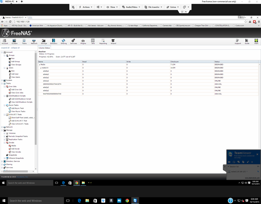

I tried to detach the bad drive that isn't there and this is what I get, the array is resilver again

That screenshot isn't as good as a zpool status. Try again with the output from the command. ;)
