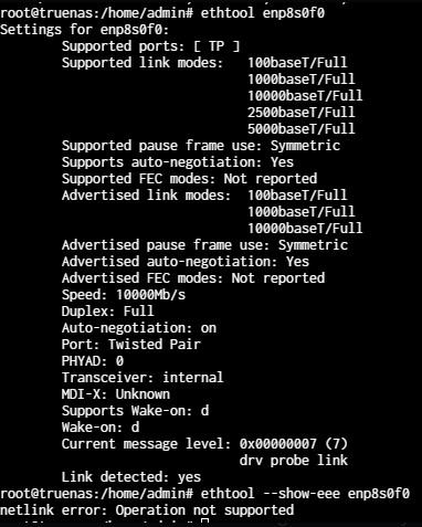

Hello, My NIC is Intel x550-T2 and I'm on Truenas Scale TrueNAS-SCALE-22.12.1. Switch is a Unifi Flex 10Gbps.
Please see the screenshot attached. I'm not having issue with establishing a 10Gbps connection. My question is why 2.5Gbps and 5.0Gbps link speed full duplex are not shown in advertised link modes? Do I need to use ethtool command to tell the NIC to include them in the advertised link modes?
Please shed some light. Thanks
The X550 predates the 2.5G and 5G idiocy, and it is quite possible, likely even, that the driver version being used doesn't support it. It is worth noting that Intel doesn't seem to have any intention to support 2.5G and 5G for the X550 on anything other than Linux at this time. iXsystems may be using the upstream Debian driver, in which case you'll need to wait for Debian to include newer drivers, or iXsystems may have a particular reason (such as the common use of X550 on various mainboards that they may be using in their products) for using a well-tested driver for this chipset that nevertheless doesn't include the gimpy 2.5G and 5G stuff. Don't know for sure, but this is the likely set of options.

So is my understanding correct, I am not able to use 2.5GbE with this card in TN Scale?
I tried to set it manually to 2.5GbE with ethtool:
ethtool -s enp45s0f1 speed 2500 duplex full autoneg off
The command is accepted, but nothing happens. When checking with "ethtool enp45s0f1" it shows the current speed is still 10000Mb/s.
I wanted to check, if and how much the power consumption is reduced with that lower speed. The card consumes approx. 15W even if there is no link.
