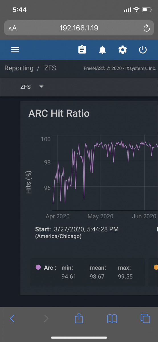

16GiB will help you, because you'll have more room for ARC, and thus can have the metadata ready in RAM. The system + Plex will use a good portion of those 8GiB you have, before you even start on ARC.
However, your mileage will vary. When in doubt, check Reporting->ZFS while you are still on 8GiB. Look at "ARC Hit Ratio" and "ARC requests demand_metadata". You want to see a hit ratio in the 90s and for metadata, way more hit than miss.

So I imagine this is good then? I’ll probably just get it to future proof it and because eventually I won’t be able to find the exact same sticks any more. I’d rather it all be matching.

2nd vote for 16 GB here. FreeNAS can stretch its legs much more with 16 and 8, and you'll get more caching on 16.
