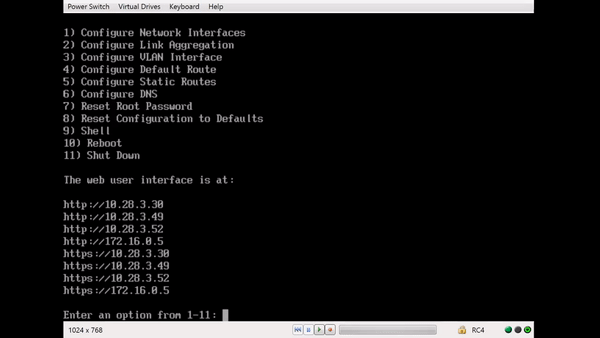

So this has been the only thread I have found that seems to point back to the same issue I have been seeing on a fresh FreeNAS install.
I moved over to FreeNAS 11.3 four days ago and found on day one that something was wrong. The "Connecting to FreeNAS... Make sure the FreeNAS system..." message would appear after a couple of hours of being on. I have my FreeNAS running on an HP Proliant DL360 so I am able to pull up the console via iLO (think RDP for bios). When I checked FreeNAS this morning, I saw the message above. I opened iLO and found that the shell could load and when i ran service nginx restart it seemed to kick me out of the shell. Odd. I opened shell again and ran service django restart and the shell soft crashed. I can press return but nothing reloads. As I press post, it has been over 30 minutes and the console is still soft locked.
I have SMB enabled for File Sharing and two Jail's running (Unifi controller and Plex). All three services are also down when this crash happens.
I have had this happen 4-5 times in the last 4 days of having the system run and am lost at how to continue troubleshooting. I saw one message hinting that the issue could be related to a bad hard drive so I am replacing one this afternoon. At this point, I just have to restart and have my fingers crossed it doesn't happen again. Any help would be great.

Update: I have replaced the hard drive that had SMART errors. I had my FreeNAS server crash at some point last night. File sharing, Plex, Unifi controller, everything is down.
When I pulled up the console, it keeps reloading the default console options. (Gif below)
I saw this post listing something similar that was related to LACP Link Aggregation. But I do not have any LACP link aggregations setup anymore.
