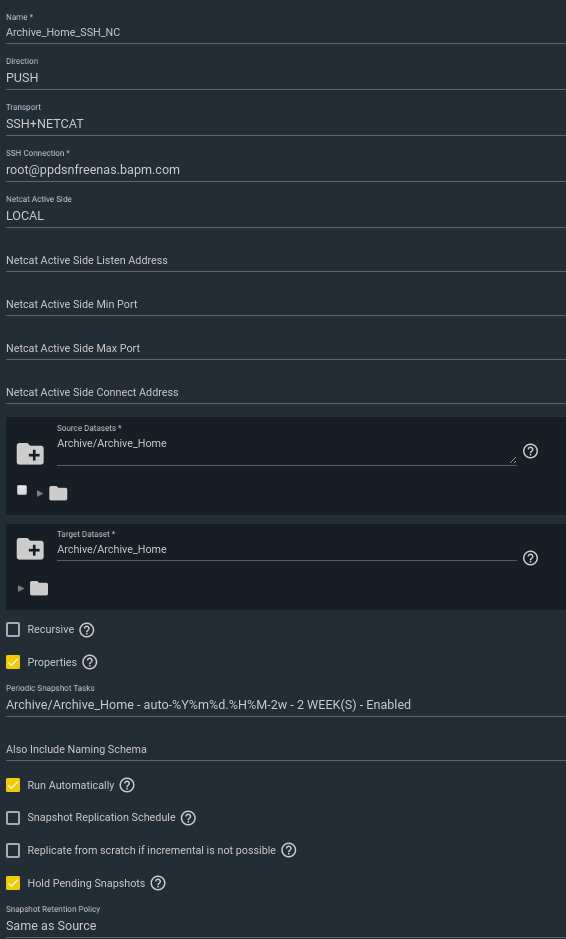

Here is the configuration of my new job:
The snapshot task selected is the same one that was used on the legacy system.
