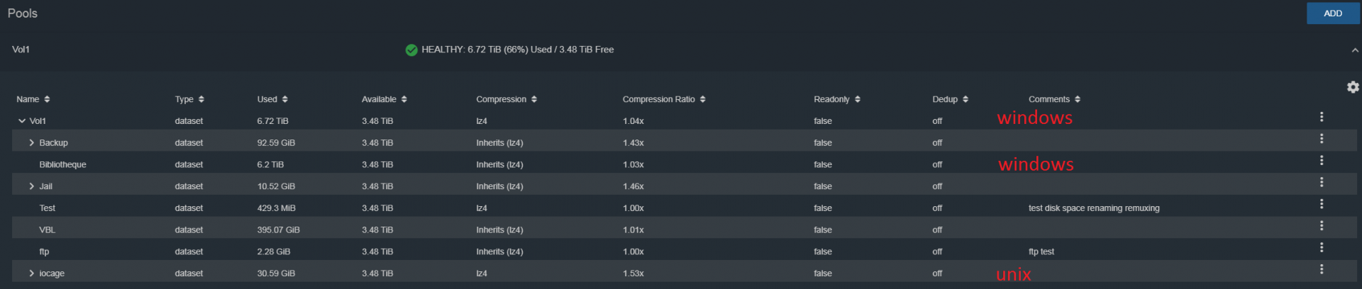

Keven
Aug 10, 2016
114
I've done a little bit of digging around and reading the logs properly and I figured my case had to do with some permissions, so I went and check my pool and in particular the iocage and checked it's settings. I noticed the share type was set to Windows, so I swapped it to Unix and now it's working again :D
@Keven, maybe check the same settings on your FreeNAS?
after checking permission i notice that my pool is in windows share, however my iocage dataset is in unix. also where my movie are stored, it's a windows's share dataset "bibliotheque"
