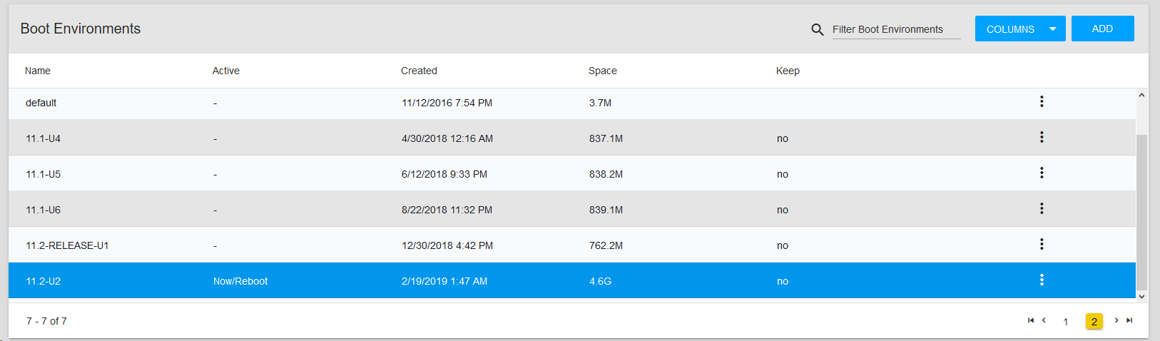

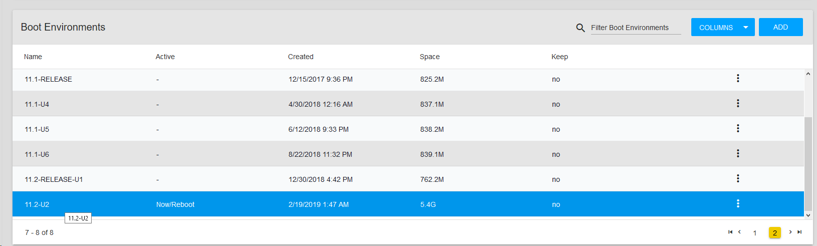

Has anyone else that's updated noticed their boot environment for U2 is massive?
Interestingly enough, if I delete an older boot environment, the size drops:
(In this case I deleted 11.1-RELEASE which was about 800mb)

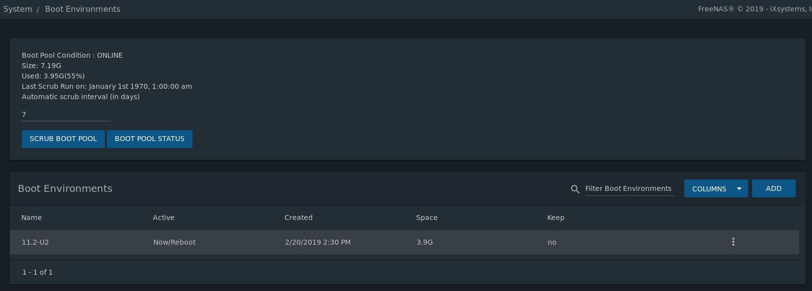

English is my first language but I am struggling to parse this statement and observe the same flawed behaviour.
Here I have a single boot environment (11.2-U2) which consumes 3.9GB so the total used vs my current boot environment is, by definition, the same. As I only have a 8GB boot device, this might potentially be an issue.
Quite why it consumes 3.9GB instead of c. 800MB is not clear but I won't be logging a bug if that is their considered response.
