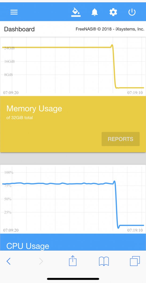

jbrown705
Sep 10, 2018
62
I too am having this issue. I’m on beta 3. I thought it may have been because I only had 8gb ram, but I upgraded to 32 and it still going on. I also noticed that when I look at the graphs in the ui it looks like just about all the memory was used until I open the ui. This same thing occurred when I had 8gb and still does now with 32. Same thing shows with cpu usage. Anyone else have same symptoms or suggestions on fix?

ByteNick
Jan 24, 2015
98
I still have it.
No fix that I know of.
IronRobi
Apr 15, 2016
52
Having the same issue here on Beta 3 and noticing the same thing on the graphs and reports. I've got 128gb of ram. About to upgrade to RC1 to see if it solves it
jbrown705
Sep 10, 2018
62
I’m on RC1 and still have the issue unfortunately.
