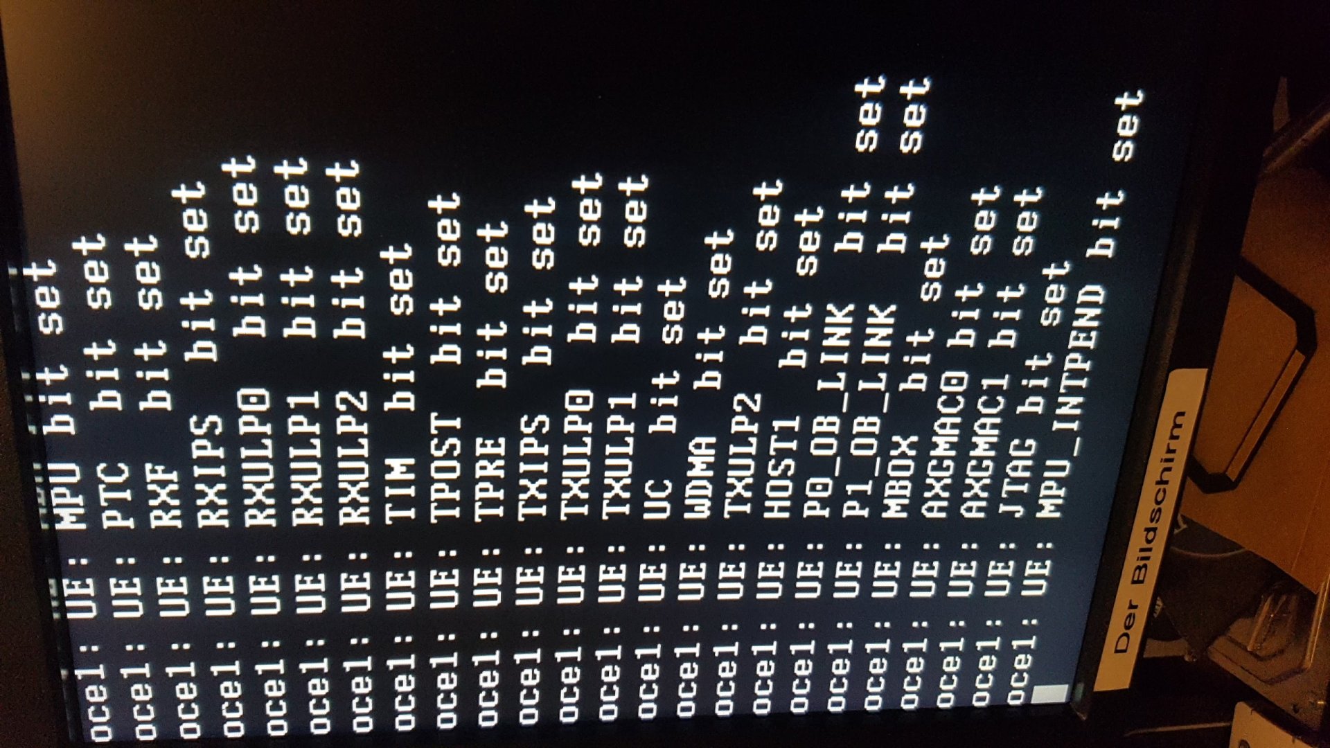

Thanks for the response @Elliot Dierksen .... I'm a bit new to the world of FreeNAS, how would I use that? I'm now getting alot more 'bit set' messages in the console. See attached:

So..... the problem has been..... (I'm hesitant to say it) solved? I've been able to transfer 3TB of data without a single 'bit set' error message... in multiple instances (1TB here, 1.3TB next instance etc...)
What I did was physically swap cards. The 10Gbe card that was in my Windows 10 box, is now in my FreeNAS box and vice versa.
In addition, I reinstalled FreeNAS. After performing this work I realized, I should've done the swap first to see if it fixes... then if not reinstall. At this point I'm not sure which of the 2 'fixed' the problem....
Anyway, this issue is done.... now I'm having 1gpbs performance through my 10gbps line. I'll take that one to a new thread though. Thanks @Elliot Dierksen for the suggestions!
