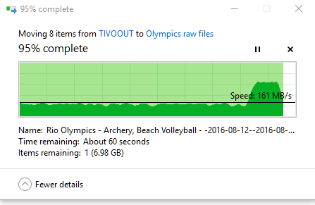

ok, did some testing.....Not great, 3.2 GB/s using:
dd if=/dev/zero of=testfile bs=1048576
Here is a wierd one...I was copying a large file during the test, I wanted to see if the copy slowed down. It didn't, but here is the wierd part, as you see from the windows screen shot, when I killed the dd test, the file write went way up, over 400 MB/s, next file started, it went back down.
See attached
