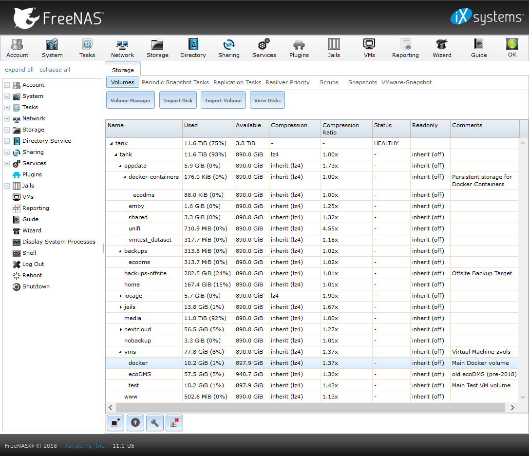

  • The main OS disk should be a ZVol for performance reasons. Since these are difficult to distinguish from datasets in the storage list, I create ZVols as children of a separate dataset (tank/vms/, see screenshot below) that is not used for anything else.
    • 10 GiB should be enough considering that all data will be persisted outside the VM (see below).
      • UPDATE: 10 GiB is, in the below configuration, actually a bad idea. I filled up those 10 GiB rather quickly when I added more containers: Images for the containers have to be downloaded and can quite quickly exceed those 10 GiB. Either go with a much larger ZVol (100 GiB?), since expanding a ZVol is a rather unpleasant experience; or mount another dataset (see next Consideration item) to hold the downloaded docker images. I went with the first option, but will probably switch to the another mounted dataset for images soon, since that will reduce the ZVol size (most of which will still be unused).
  • Docker will eventually host multiple containers, most of which need data to be persisted. How should those 'persistent directories' be handled between FreeNAS and Docker VM?
    • SMB has better permission granularity using ACLs, but NFS is faster than SMB [Citation needed] and granular permissions are not necessary for Host/Container communication so we're using NFS. NFSv4 is faster than NFSv2 and NFSv3, so that's what we'll use. If you have clients that require NFSv3, ignore the respective settings in the NFS section.
    • We can either mount one 'docker-appdata' dataset into the VM and create subdirectories for each container, or create multiple datasets and mount them individually.I chose to create a dataset tank/appdata/ that contains child datasets for each jail or VM that needs data to be persisted. For the Docker VM, I added a tank/appdata/docker-containers/ dataset that in turn contains child datasets for each container (see screenshot below). Remember that, as per the note above, you can only share leaf datasets(that is, datasets that have no child datasets)!
      • Each dataset underneath tank/appdata/docker-containers (e.g. tank/appdata/docker-containers/ecodms/ and tank/appdata/nextcloud/) must be shared and mounted in the guest OS individually.
      • If you create another level of child datasets (for example /tank/appdata/docker-containers/nextcloud/db/ and /tank/appdata/docker-containers/nextcloud/files/, because the Nextcloud database needs different settings than the files dataset), you must share those individually instead of sharing the nextcloud dataset.
  • We'll choose Debian 9 ('stretch') as the VM Guest/Docker Host OS - it has a lightweight, console-only installation and strongly favours stability over adding the latest package versions. (Also, I couldn't get CentOS or Ubuntu Server Core to do what I wanted them to.)
    • Get it from debian.org > Getting Debian > Download an installation image > Tiny CDs, flexible USB sticks, etc. > amd64 > netboot > mini.iso

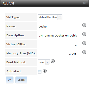

  • In the FreeNAS UI, go to VMs and add a new VM.
    • As Boot Method, we'll pick UEFI
    • Virtual CPUs: 2 (or more; 1 isn't a good idea in times of ubiquitous multithreading)
    • Memory Size (MiB): 2048 (I chose this as a starting point; depending on your containers' requirements)
    • Autostart is currently pointless if using an encrypted volume, since bhyve VMs are not automatically restarted when decrypting the volume. This may change with future FreeNAS updates however.
