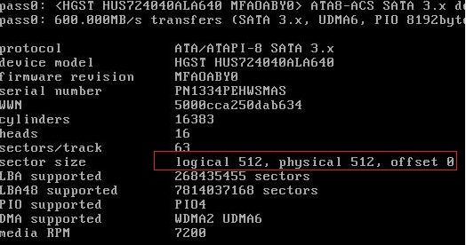

I am using HGST HUS724040ALA640 disk, unfortunately freenas detected my 3x4TB disks as 512 logical/physical so I guess I would not achieve 4k performance. Can I manually do ashift=12 to fix this?

I actually assumed that freenas will detect my drive as 4k but after I run camcontrol identify just now it showed up that its not.

FreeNAS only knows what the drive tells it.

Yes you are right kdragon75, after searching in the internet about this drive, its seems like its not really 4k but a 512 native instead.
I guess I have to accept it. Could I ask for a help how to have a decent performance for this 512n drive?
*I am setting up the freenas on a hosted server. The hardware is preconfigured so I would not be able to replace the disks. I probably going to have another hardware next year with 4k drives in it then perform data migration to fix this issues.
4kn drives are about capacity not performance. I can't help tune performance without knowing either exactly the type of performance you want or the exact workload. And no "some VMs on ESXi" is not a discription of a work load.
