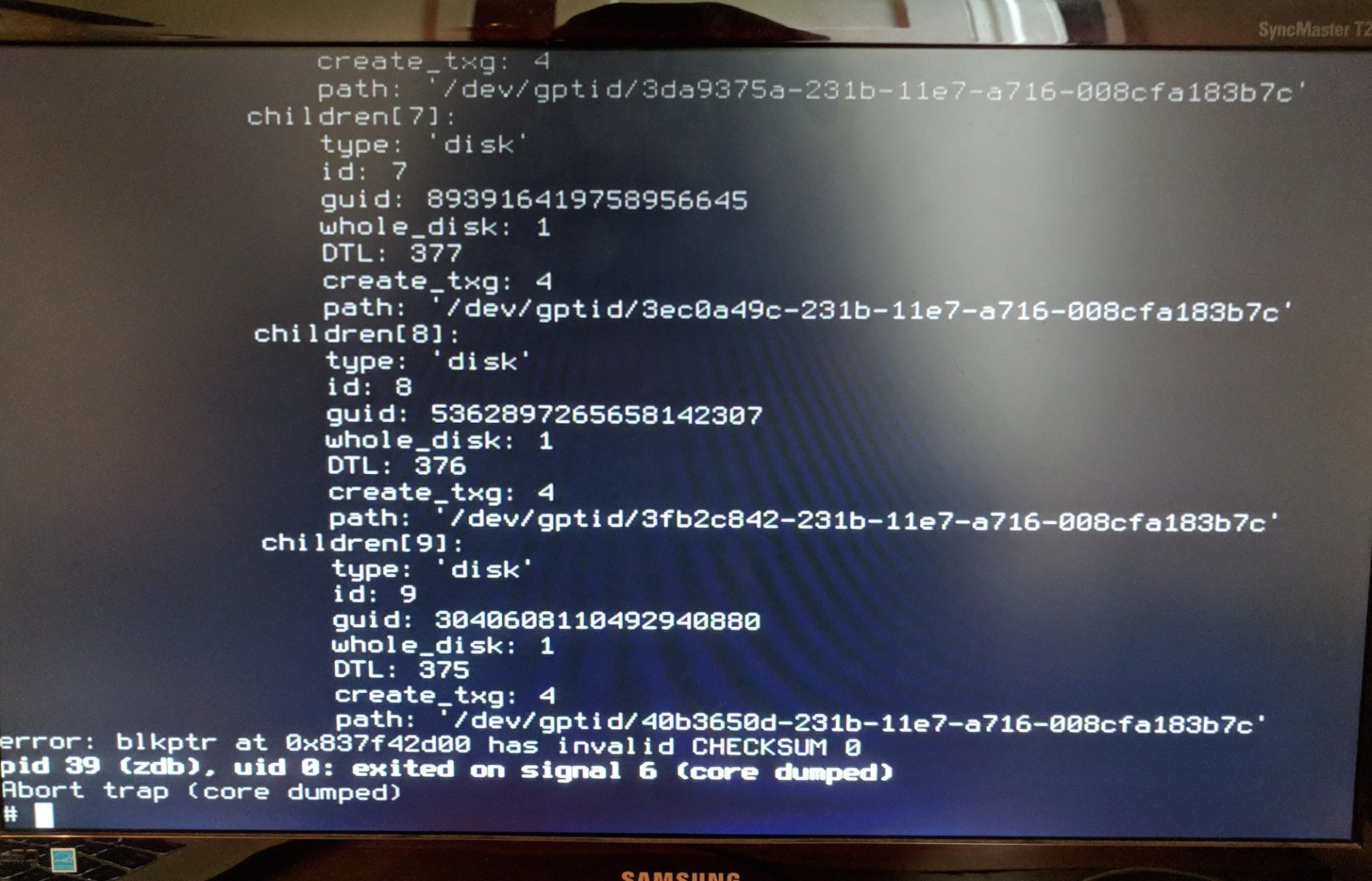

I installed live version of mfsbsd on USB and booted into it.
zpool import still shows the "media" pool online and all 10 HDDs available, but when I try to import and mount it on /mnt/media, kernel panics and system reboots.
While going over THIS thread, I ran into a helpful command that shows what might be causing the kernel panic.
After running zdb -e -F media, I get the following:
error: blkptr at 0x837f42d00 has invalid CHECKSUM 0
pid 39 9=(zdb), uid 0: exited on signal 6 (core dumped)
Abort trap (core dumped)
Attached is the screenshot of the error.
