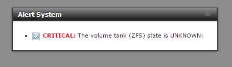

Just Created my first FreeNAS setup less than 2 months ago, all new hardware too. Now, after working fine for last few months, it seems to be unable to read the zpool I have all my media on. I read some of the other threads where people were seeing same error messages, but wanted to ask since I know I can't really interpret the info that was requested to see how similar mine is. I also would be really surprised more than 1 drive failed at same time, since I did have some redundancy.
Anyway, I attached image of error message, and below are some of the readouts and hardware/version numbers

If I'm reading the import section correctly, is it saying 3 of my drives are unreadable now? Seems real bad luck on my part to have 3 different 3 tb drives fail at same time, within 3 months of purchase. If that is the case, I assume I'm just kind of screwed on data that was on there.
It does seem to be saying that, and it does seem pretty unlikely, but if true, yes, your pool is gone, and so is your data if you have no backup.
However, it seems more likely that some other kind of hardware failure is preventing detection of those three drives. Testing options range from things as simple as swapping cables or trying different HBAs through to transferring all the drives to a different machine and attempting to import the pool.
Hopefully you realize your hardware isn't a good match for FreeNAS, and RAIDZ1 is a poor choice unless the drives are 1TB or smaller.

I agree with all of Trevellyan's points. I would try checking the connections, and the cables themselves. I don't think this user is using an HBA, I think he's just on motherboard ports.
Also, this is very bad, non-server grade hardware for FreeNAS. I would strongly encourage you to consider using hardware more appropriate to this appliance.

Thank you for your responses. It did end up being cabling issues. Whether it was the SATA Cables or power cables I'm not sure, but my case is a bit tight and some of the cables were loose. I also added some extra power cables from my modular PS, and swapped some SATA Cables.
