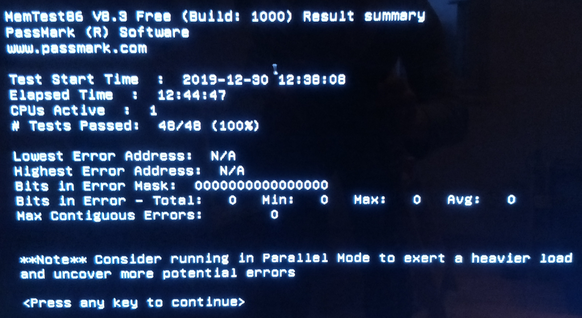

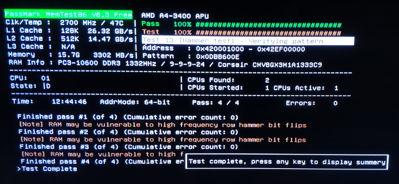

@styno: Here are the results of the MemTest86. It says 0 errors and Tests passed 100%.
Is the note in the screenshot 1 a concern?
@toadman: Is there any chance I could lose data while saving and uploading the config?
