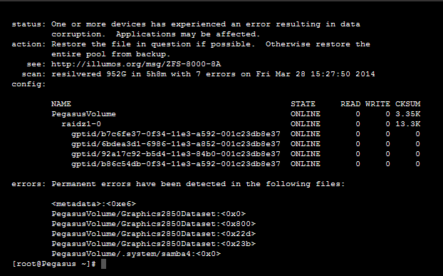

Last week my server detached two drives from the RAID controller. I was able to restore the controllers configuration without replacing the drives. However, after the system had been up for a short time one of the drives died. I've replaced the bad drive with a new drive. The system says that the storage, datasets, and drives are healthy and online, but running a zpool status -xv shows me that there are corrupted files. The system is also still showing a warning message about data corruption (message below). I've fixed the files that are actually files of mine, but the rest look like system files. How do I clear the system of these errors?
Warning Message:
WARNING: The volume PegasusVolume (ZFS) status is ONLINE: One or more devices has experienced an error resulting in data corruption. Applications may be affected.Restore the file in question if possible. Otherwise restore the entire pool from backup.

You can't. Your pool has suffered irreparable damage to the pool's metadata. In effect, your pool could fail you at any time and you'll never be able to access the pool again. You need to do 2 things to solve the problem:
1. Get rid of that damn RAID. That's a recipe for nothing but problems. We keep telling people not to use RAID controllers and they keep ignoring the warnings.
2. Destroy and recreate your pool, and this time use RAIDZ2. Again, RAIDZ1 is a recipe for nothing but problems. We keep telling people not to use RAIDZ1 and they keep ignoring the warnings. Its been such a problem I've put a damn warning in my sig... and people still do it!
The corruption you currently have on your pool cannot be fixed. Proper management of your hardware/disks, ZFS format, and ensuring pool resiliency is suppose to prevent the kind of corruption you have. But, due to your mistakes I've mentioned above you have failed ZFS. I'd seriously consider destroying and recreating your pool from backup sooner than later!

Hi NicCrockett,
If that system you asked about is holding company data then I'd say the company you work for is already very much at risk.
That said, everything you wrote above pretty much avoids the problem you initially asked about. Really the only thing you can do is dump the data off and rebuild the pool. While you are at it (and the surviving data is somewhere safe) I would address whatever caused your controller to drop 2 drives.....my guess is you have a RAID card presenting individual disks to FreeNAS, which isn't as bad as using proper hardware RAID it is still far from ideal.
