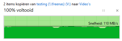

I've created a new dataset on my freenas server and put a single file on it of roughly 6 GB. This is a dataset on the pool with the normal spinning disks. When I copy this file from my new freenas server to my own PC I'm getting just over 100 MB/sec read speed (my PC has an SSD).

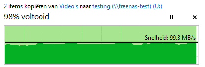

When I then copy that file to my freenas-test server from my PC I see similar write performance:
This leads me to conclude that my new freenas server should be capable of sending at 100+ MB/sec and my old freenas-test server should be able to receive at a similar speed. After this I created a snapshot of the newly created dataset and used ZFS replication to copy it to my freenas-test server and I'm getting roughly 51 MB/sec as my transfer speed.

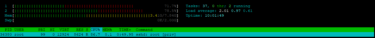

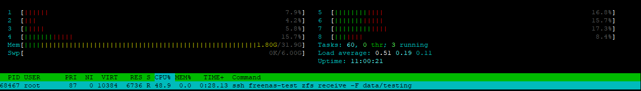

I did some searching and found that I have access to htop on FreeNAS. I did the replication again and here are the results. I took these screenshots halfway through the replication proces (so about 3 GB of the 6GB).
From my new FreeNAS server sending the data
From my old FreeNAS server receiving the data
CPU usage on the receiving server between 70-80% with spikes to 90+% average transfer speed again the same around 51 MB/sec.[/ICODE]
l@e
Nov 4, 2013
143
Ssh is killing the old nas cpu. So reaching the same 100+ MBps that you get from smb will be difficult.
