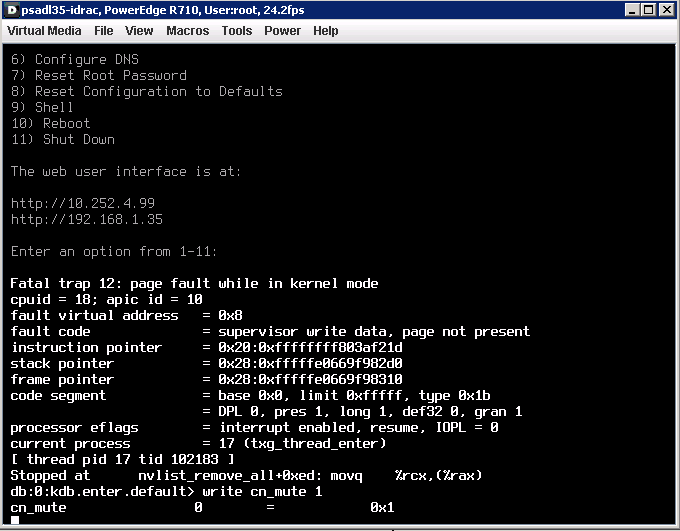

zrep - ZFS send/recv a ZVOL from Nexenta or Solaris to Freenas will crash Freenas.
Attempting to ZFS Send a zvol from Nexenta, Solaris or OpenSolaris - kernel page faults Freenas 11.2 - and forces a reboot.
Fatal trap12: page fault while in kernel mode - see screenshot.

Is there a freenas bug for this? A simple zfs send / recv shouldnt be able to take down my system....

Ive tested it on 2 systems, 11.2U4 and 11.2U5. Its not a hardware thing. (intel xeons, 64GB ram, LSI2008 controllers, one all SAS drives, the other all SATA)
I believe its something to do with the ZFS options that get sent with the zfs send - Ive fired up a test instance to work out exactly which options it is - hopefully by later in the week I'll be able to isolate it to a simple test case.

So far what testing has found:
A straight zfs send | recv of a zvol works fine.
Sending the zvol with options appears to be what kills it - which is extremely similar to the bug report first linked.

OK, more details...
It Doesnt seem to trigger on 11.2U5, but certainly does on 11.2U4. Maybe there was a fix in there?
Its definitely related to zfs send | recv with properties included - sends without properties all work fine - however, if the issue is fixed in U5, then theres no point me investigating further.
