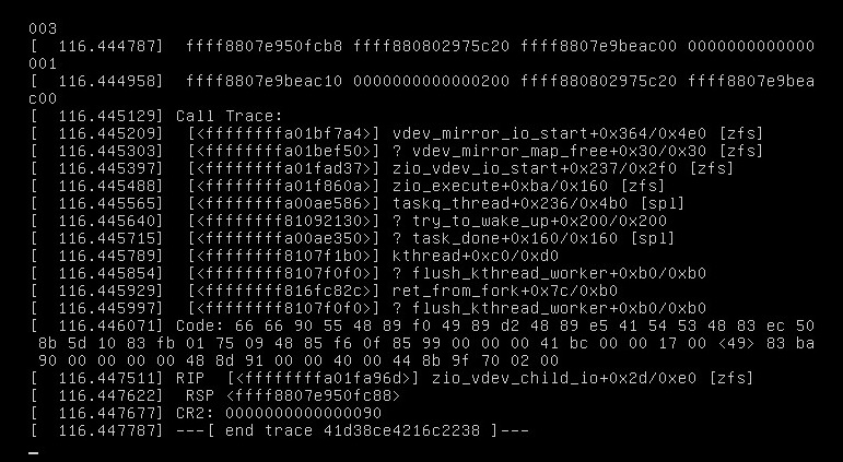

Ubuntu 12.04.3 server x64

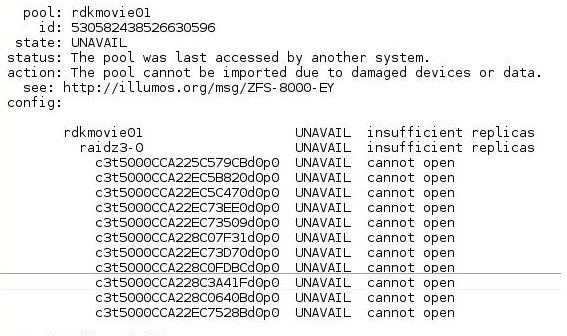

Openindiana dev151a8 x86
zpool import sees the pool but says all its drives are unavailable (openindiana_zpool_import.jpg). zpool import -f rdkmovie01 results in 'invalid vdev configuration'
