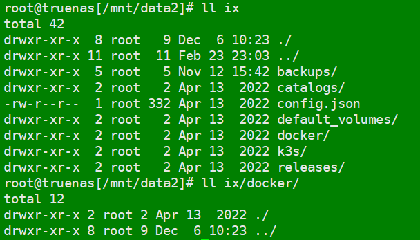

zfs snapshot data/ix-applications@snap1
zfs send data/ix-applications@snap1 | ssh 192.168.188.22 zfs recv data2/ix
The files under docker are not copied. Commands send other datasets no problem

My first guess is that since you're not doing a recursive snapshot (and not sending it recursively either), the content you're missing is actually a child dataset, hence not in your snapshot and not sent.
Perhaps an additional interesting note is that I think I've seen somewhere (maybe from the TrueCharts folks) that you can't really replicate the ix-applications structure for any useful purpose other than maybe to restore back after pool loss.

There is indeed no recursion. There is a total of 10T+ data under docker, which can be seen on the command line, about 1G/s is too slow
