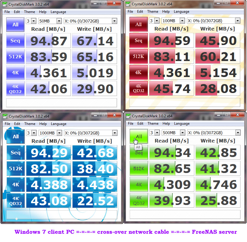

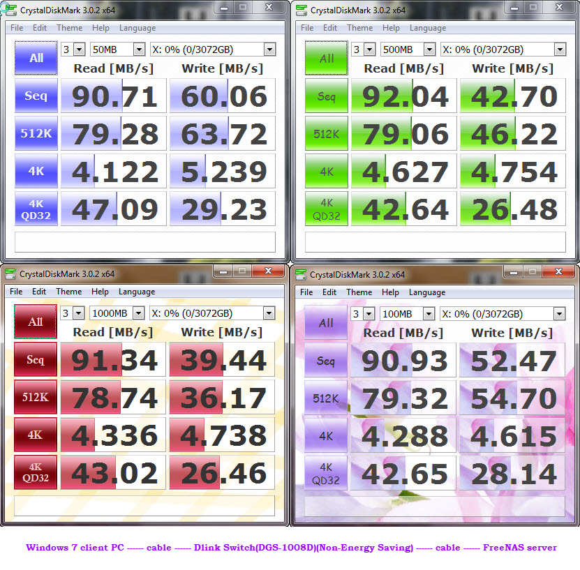

Using a Dlink DGS-1008D H/W Ver: C5 (non-energy saving) switch,
previously I was using the Dlink DGS-1008D H/W Ver:E1 (Green switch).
Surprisingly, the write speed has improved somewhat but still significant.
So, this proves that Green switch(energy-saving) (H/W Ver: E1) has higher latency than
its previous model (non-green switch) H/W Ver:C5 but heat generated by this switch
is of course a bit warmer, comparing to the Green switch.
Ok, I have done 2 separate test here:
1) Test with cross over cable
2) Test with non-cover cable (2 network cables + a Dlink DGS-1008D Ver:C5 -non-energy saving)
Please see the screen capture below:
