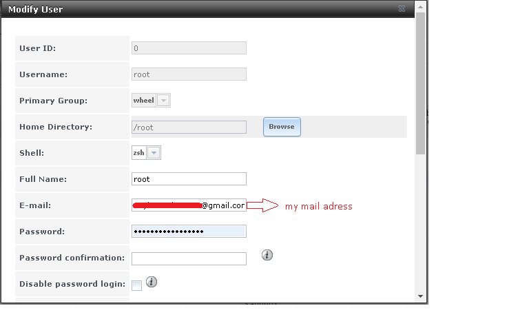

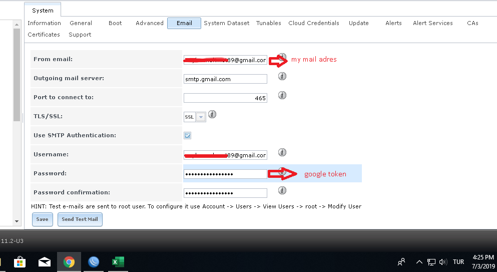

hi,i have a similar error. I tried to set up mail and when i try send test mail, I get this error "
  • Your test email could not be sent: [EFAULT] Failed to send email: Connection unexpectedly closed
i checked Periodic Notification User "root" and Accounts ‣ Users "root" same .... i checked ip , DNS and gateway ... i am useing this mail adress in mikrotik router with another one google token....dont know what else can i try. i want to use mail for alerts pls someone halp me...

Sep 28, 2015
269
try port 587.
try another email service.
this is another kind of error, but probably google is not accepting your <DATA> or not accepting your source IP, terminating smtp conversation.
