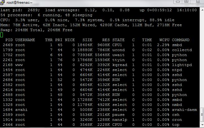

Reading through the FAQs and forums, it seems like slow copy is generally related to memory. Here's what top looks like while the copy is going. It looks to me like the system is not running out of memory:
last pid: 22399;  load averages:  0.14,  0.05,  0.01    up 1+13:50:21  11:19:46
42 processes:  1 running, 41 sleeping
CPU:  0.0% user,  0.0% nice,  0.3% system,  0.0% interrupt, 99.7% idle
Mem: 141M Active, 45M Inact, 1789M Wired, 4300K Cache, 205M Buf, 1236M Free
Swap:
  PID USERNAME    THR PRI NICE   SIZE    RES STATE   C   TIME   WCPU COMMAND
 2099 root          7  44    0 67092K 10120K ucond   3   0:40  0.00% collectd
 2470 www           1  44    0 19324K  4248K kqread  1   0:07  0.00% lighttpd
 1998 root          6  45    0   182M   114M uwait   2   0:06  0.00% python
 1736 root          1  44    0 11776K  2796K select  1   0:02  0.00% ntpd
 2795 root          1  44    0 33300K  5128K select  1   0:01  0.00% sshd
 2757 ted           1  44    0 33300K  5128K select  1   0:01  0.00% sshd
 6475 root          1  44    0 38060K  6816K select  1   0:01  0.00% nmbd
 2214 root          1  47    0  7832K  1516K nanslp  1   0:01  0.00% cron
22362 root          1  44    0 47928K 10888K select  1   0:01  0.00% smbd
 6446 avahi         1  44    0 16932K  2852K select  1   0:01  0.00% avahi-daem
 1296 root          1  44    0  6904K  1520K select  1   0:00  0.00% syslogd
 2755 root          1  44    0 33300K  5052K sbwait  2   0:00  0.00% sshd
 2559 root          1  76    0 64096K 24452K ttyin   1   0:00  0.00% python
 6479 root          1  44    0 46632K 10252K select  1   0:00  0.00% smbd
 2384 root          1  44    0  7836K  1644K select  1   0:00  0.00% rpcbind
 2760 root          1  44    0 13408K  3020K nanslp  1   0:00  0.00% smartd
 2797 root          1  44    0 10172K  2904K ttyin   0   0:00  0.00% csh

b1ghen
Oct 19, 2011
113
Swap:
Isn't there supposed to be some swap assigned?
On my 6 drive RAIDZ2 I have 1 GB set aside for swap on each drive so I have 6GB of swap available when I run top:
last pid: 17871;  load averages:  1.07,  0.50,  0.29   up 12+23:20:16  22:37:12
39 processes:  2 running, 37 sleeping
CPU:  2.9% user,  0.0% nice, 66.0% system,  6.6% interrupt, 24.4% idle
Mem: 8848K Active, 69M Inact, 3431M Wired, 6868K Cache, 205M Buf, 398M Free
Swap: 6143M Total, 17M Used, 6127M Free
Also my smbd process is taking up a lot more than 0% cpu when a copy is running.
