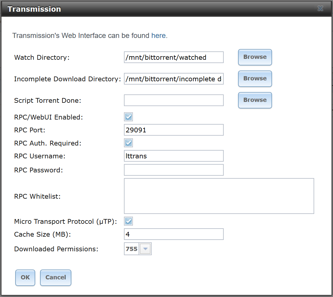

Also Ive installed transmission and after a bit of fiddling about reset most setting as i need but i cant find where to change these setting.

Ok i found this old post https://www.ixsystems.com/community/threads/transmission-watch-directory.68930/
Basicly for me i had to look at the old settings in /mnt/Sdata/jails/transmission_1/var/db/transmission/settings.json and opened this is putty,
then opened /mnt/Sdata/iocage/jails/transmission/root/usr/local/etc/transmission/home/settings.json again in putty,
just looked at the setting and made the changes in the new one (/mnt/Sdata/iocage/jails/transmission/root/usr/local/etc/transmission/home/settings.json)
But it doesnt work, and also noticed the download location keeps being overwritten every time the jail restarts?

Ok so transmissions looked like it was working fine but now its showing error permissions denied, for the old version/old plugin the GUI had "Downloaded Permissions: 755" not sure if this is why the new version is having the permission error and not copying from "downloading" folder to the "complete folder", cant find it anywhere (alhough my eyes are popping out of their sockets its so late!!!)
any thoughts please. makes you think "just stick with the old one"!! plus as i was getting further with transmission i havent done much in trying to get qbittorrent working. I do like now transmission has both windows app android app, all to help manage downloads.

For permissions inside jail we use command chown for setting user/group for folders....for example chown user:group /mnt/media
For settings permissions for user, group and others we use chmod ....for example chmod 755 /mnt/media
All commands are on freebsd wiki Here for example

but why do they need to be changed it as the old jail/transmission worked fine to these folders? Also from outside the jail folders (ie /mnt/Mdata/NewTBC for example) are already set to drwxrwxr-x+, and from within the shell of the jail it is set to drwxrwxr-x+.
So why is transmissions saying permission error. does it need to be set to 777? or is there another config file somewhere to change transmissions permission/user. I though i saw somewhere user=root ? maybe not??

Do you have SMB set up for accessing directories where you store downloaded files ? Windows permissions often break unix permissions

yes it is, but like i say the old transmission jail/plugin still works and can write to files without error (i might have to test that again though) is it best to just rerun the chown and chmod anyway? current folders are root:1001 and drwxrwxr-x+ , the folder inside is set to transmission:1001 and drwxrwxr-x+. do you think its worth resetting all to root:1001 (1001 is media group) and 755?

So if you have SMB access to you downloaded files I had very tough times to get it run, because permissions always change when I have accessed directory. After that transmission or qbitorrent shows error permission denied and I needed to remake permissions for folder.
Try to temporarily deactivate SMB and change permission to 755 inside jail for folders that need to have access to your bittorrent app, and of course run chown for the directories also..then if it doesnt work post here log of command ls -all where you can show if you have permissions set up correctly.
And yes transmission downloaded permission does need to be set to 777, otherwise is didnt work for me too.

i can run chown but when i try to chmod i keep getting "operation not permitted" cant figure out why. any thoughts. SMB is off at the mo as well.

After so testing it is permissions as in chmod 777 but i cant change it as i get error operation not permitted. so how can i fix this? tried chown but its already set to the same as per my test folder.
strange how it was workign fine on old transmission before upgrading so something has changed during the upgrade!
