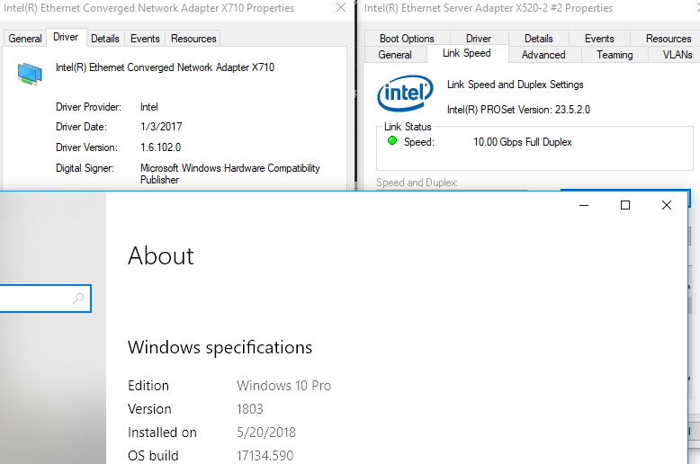

fworm
Mar 4, 2019
4
I can confirm I have installed an Intel XL710 on Windows 10 with the drivers provided by Intel, working fine. (My test was single direct connect peer-to-peer between two Windows 10 boxes each running an Intel 10GbE nic, which worked perfectly fine.)
I also played around with Teaming on a Quad Gigabit card, but that ended up blue screening and such, so, maybe some weird bugs to work out if you are looking at 40GbE...
Edit: Wait- you used a 10gbe card instead of the 40gbe card? Then yeah, I don't know if that counts as working or not. It's the 40gbE that intel claims doesn't work :( (although all x710 cards appear in the banned list, so that's a much more positive outcome than I thought)
I can't doubt your statement as... it's working for you. I just reference this, and what Intel support told me directly:
https://www.intel.com/content/www/u...020905/network-and-i-o/ethernet-products.html
So that makes no sense- Intel flat out told me it wouldn't work, and they weren't going to be releasing drivers.
Can you post what rev drivers you have?

fworm
Mar 4, 2019
4
I appreciate it. Although I've already bought other cards, it will help someone else I'm sure.
Intel drivers: 23.5.2
Windows 10, update 1803
Both X520 and XL710 work (just had the XL710 in my NAS box when I took the screenshot.)

purduephotog
Jan 14, 2013
73
Well, there ya have it. Good news is your post should be able to help other people.
