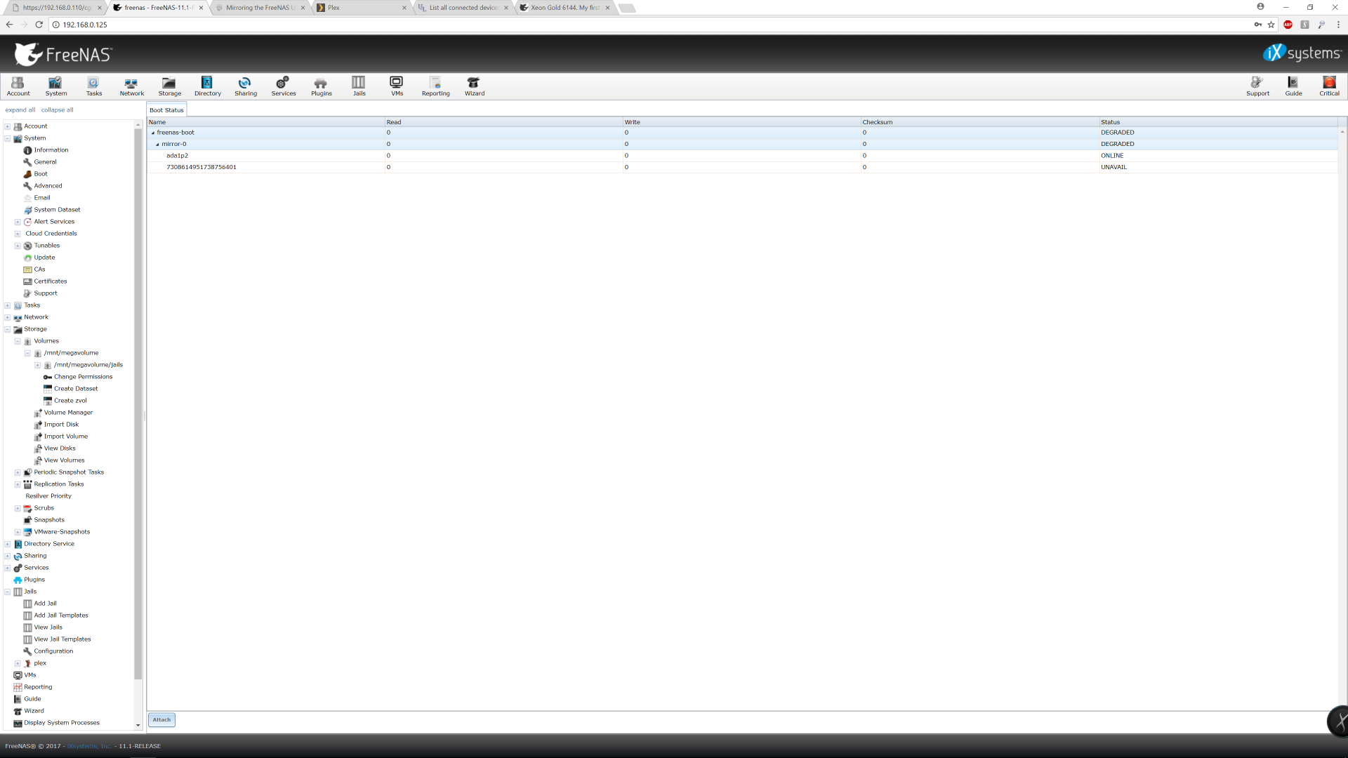

Now all the hardware has been installed and I have managed to install FreeNAS. I made a few mistakes after mirroring, and wanted to do a fresh install.
I reinstalled on the ada1 and booted up. Now the system says that my boot environment is DEGRADED...
I thought I made a clean installation... Does this mean my installation or system boot failed, so that it booted up from the old disk? I see Plex is running which I had running on the old drive... Perhaps the system couldn't boot from the freshly installed drive and used the second (old) one? I saw when I tried to boot the fresh installation-drive, just now, that it started off fine with GRUB etc. then all chars got garbled and the system rebooted! Perhaps this is what happened?
styno
Apr 11, 2016
466
If you want to install directly to a mirror you have to select both drives instead of only one.
If you want to reinstall to a single drive and leave the previous one in your system, you have to make sure the correct drive is selected during boot.

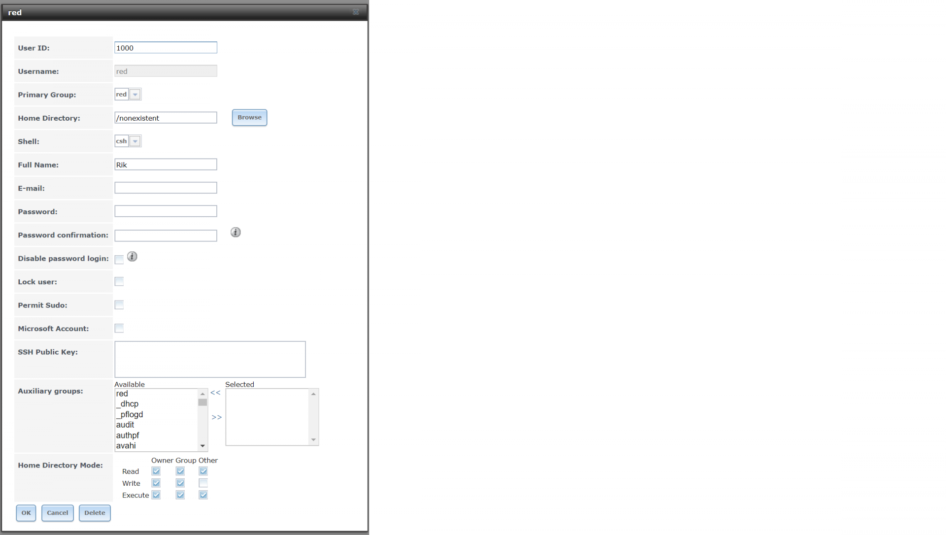

I'm back. This time I am doing it slowly but surely. Instead of installing Plex as root, I have created a user called 'red'. I picked a very simple password (like 566) and I can't login. More complex passwords doesn't help me. Even after I restart the system, I can't login as that user. Anyone spots what could be wrong here ?
