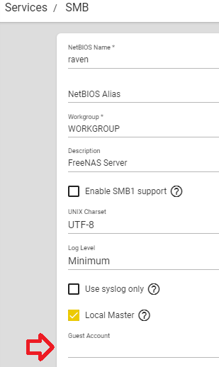

  2. Then, in the SMB service, set wb as the guest account:

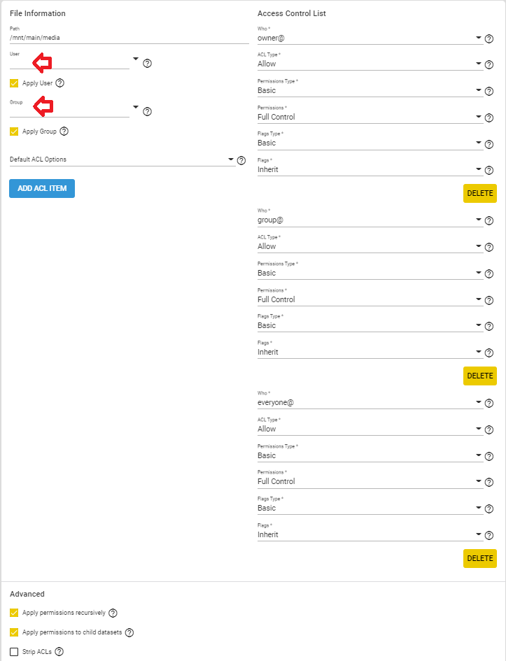

  3. For your share, set the permissions as follows, filling in the user/group fields with your wb account and group (adjust as needed for your specific account and group):

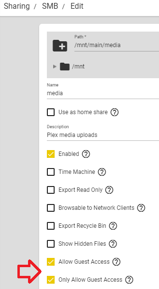

  4. Finally, in the share definition, enable guest access by checking both boxes:
  5. Restart the SMB service after all these changes. You will now have login-free access to this share from all machines.
